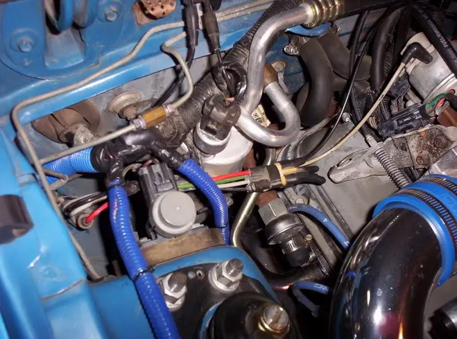

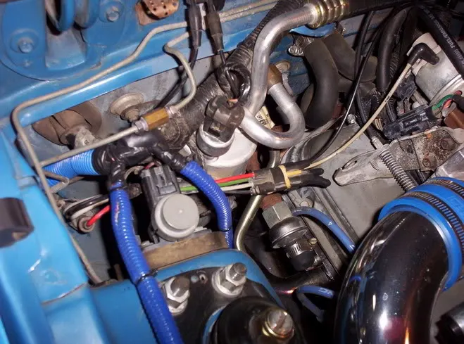

i have all the original parts. smog pump, steel line (from h-pipe to pump), all silicone hoses, and valves. everything you need to put it back original. you may also want to check the backside of the passenger strut tower to make sure the silonoids are still there, i have those as well. here is a before and after pic so you can see what silonoids went to that. feel free to email or PM me.
before:you can see the gray tops of the silonoids.
after: wire hiding just started so it aint perfect yet.
