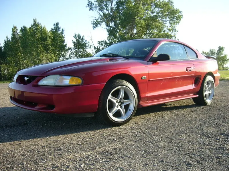

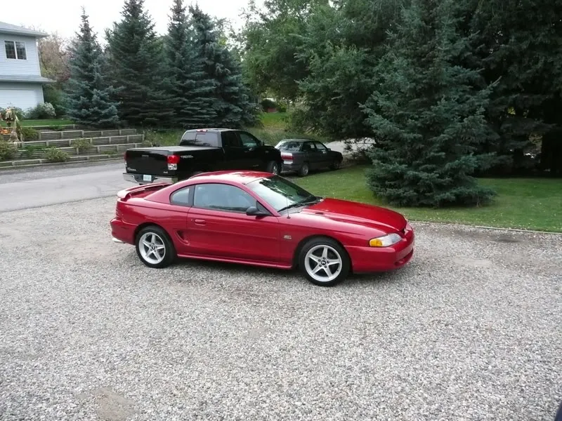

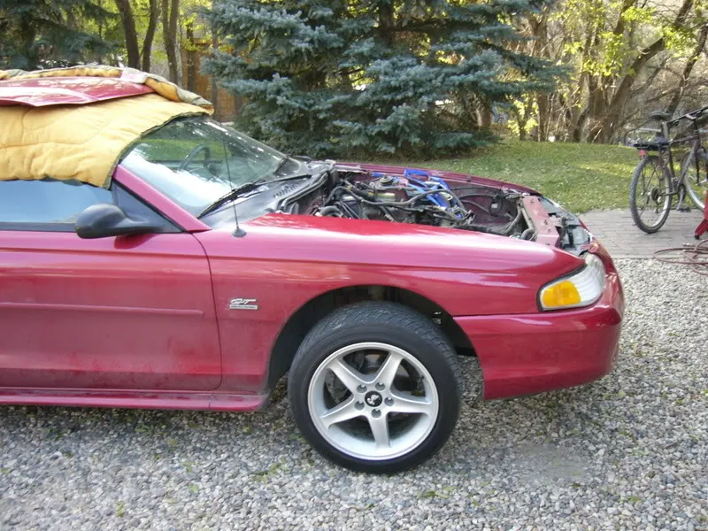

Here is a before/after shot of Ford racing 'B' springs on my 94GT, it wasnt a huge drop, but its exactly what i was looking for:nice:
BEFORE
AFTER
CURRENT:D
