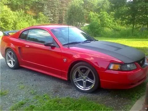

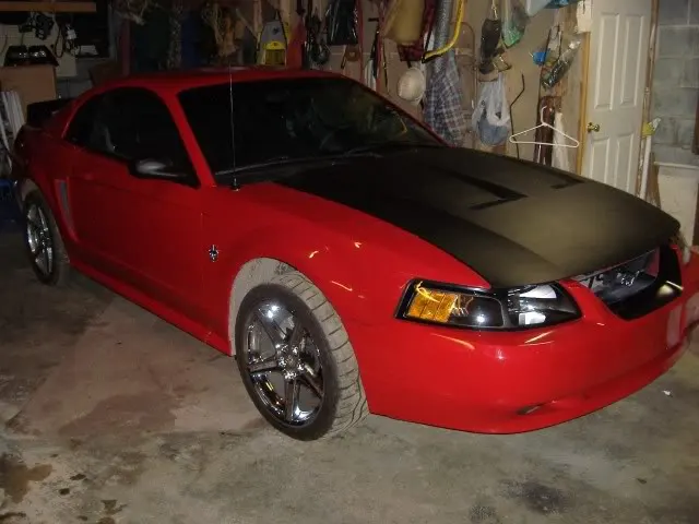

H&R SS, Tokico Blues, MM Caster Camber Plates installed --pic--
Before
And After
It handles so much better, next up is window tint and MM FLSFC's :nice:
I'm asking b/c if the control arrms are not vertical you are gonna get severe bumpsteer, you need longer ball joints, thats kinda why I refuse to lower my stang, to much extra stuff to get besides springs and cc plates. Just askin, there must be a lot of flat streets where you live.
