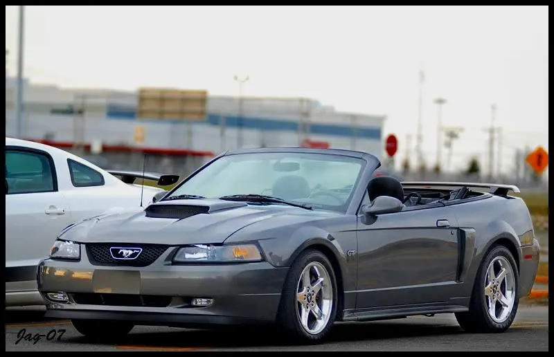

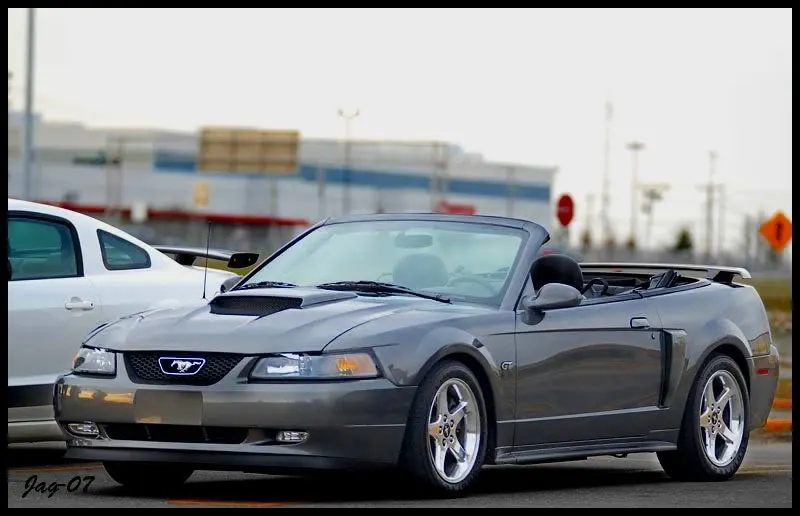

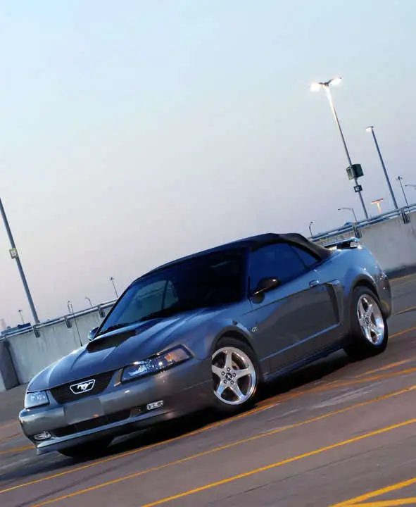

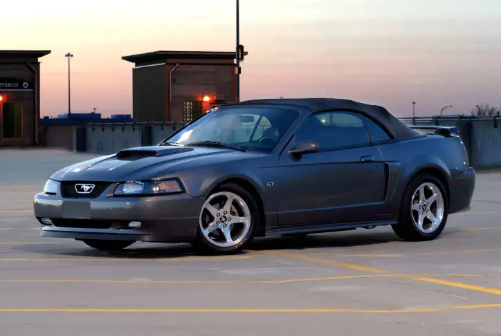

I was going to respond to the original post but then realized I did, 2 years ago.
Anyway here are some pics.
