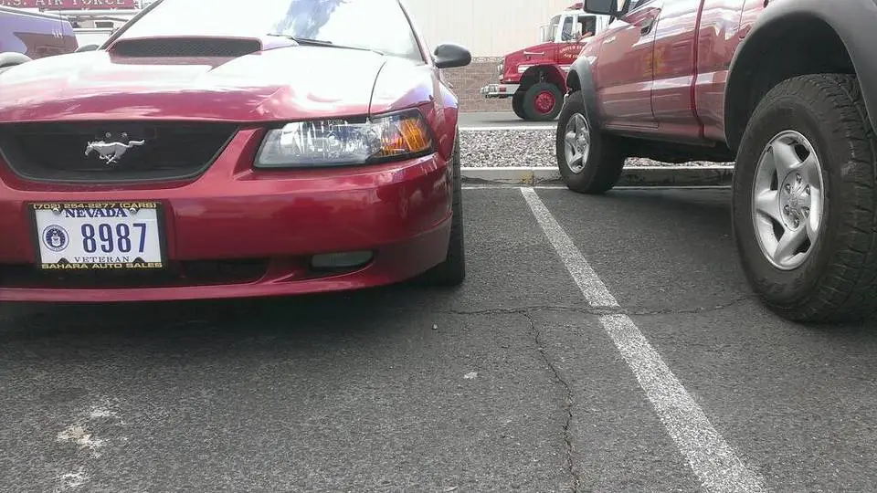

H&R race, no iso's, no cc plates. With the iso's our cars are probably about the same heighth. That pic gives it a bit more camber than what it has. Believe it's around -1.25 degrees. Fords limit is -1.5 degrees.
