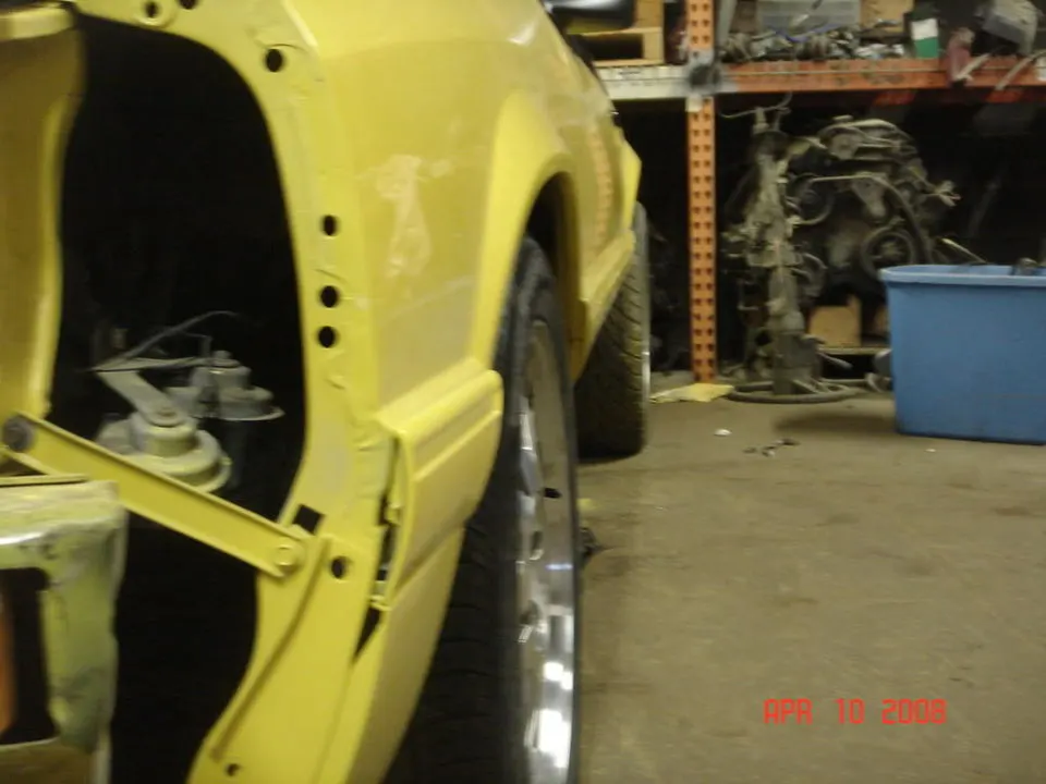

Langwilliams---Watch out for 94-04 LCA's. They are 1-1/2 inches longer than fox body LCA's so they will make the wheels stick out past the fenders quite a ways. If you want to run 05+ wheels, use stock Fox LCA's, and 96-04 spindles. I tried that set up, and they do not rub on the strut because they push the wheel out 8mm further than 94-94 spindles. They will rub with 94-95 spindles....here is a pic...

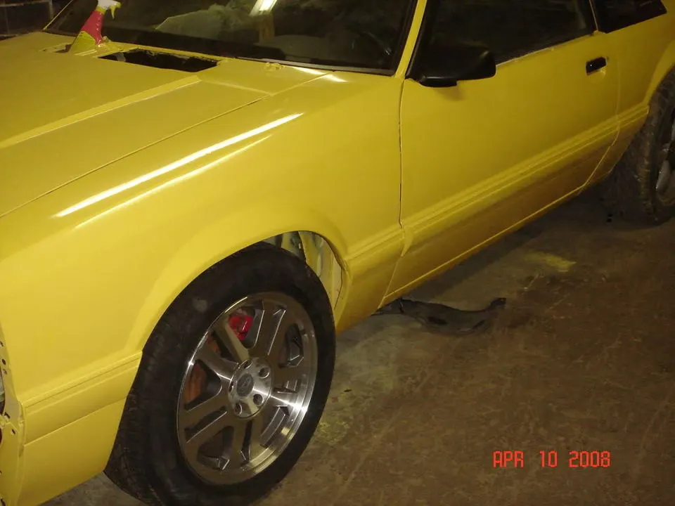

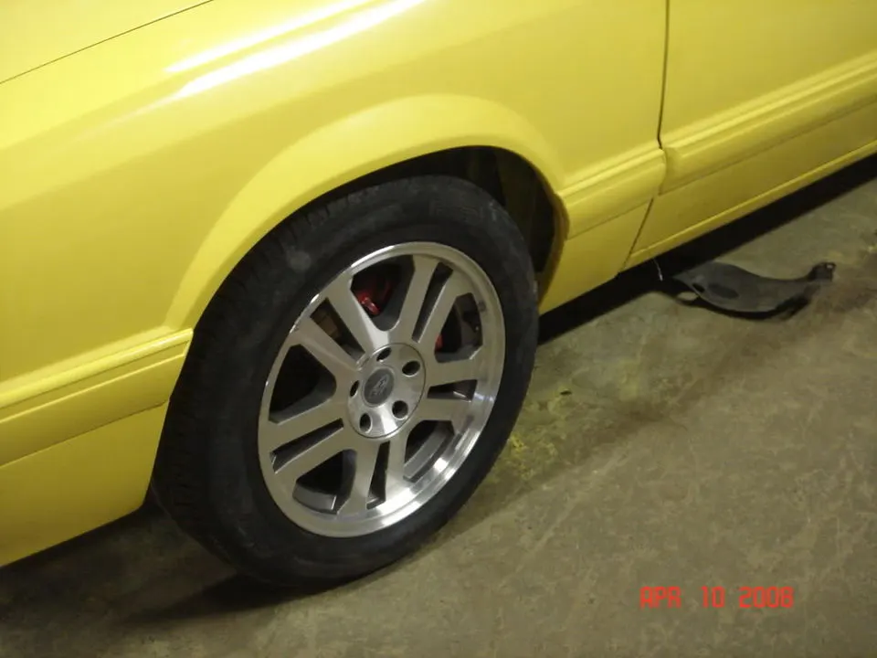

With the 2001 axle, I need 17X8's with a +30mm offset...(smallest offset)
Or the ideal wheels is a 05+ wheel. +45mm offset in a 17X8 or 17X9.
I seriouslly think I'm gonna bite the bullet and buy the Ford Racing Bullit 17X8 +45mm 05+ wheels in a Polished finish. They are 794.75 with shipping. That is crazy expensive. I'm used to getting wheels in on Mustangs at work, and not paying a damn thing for them...hehe
