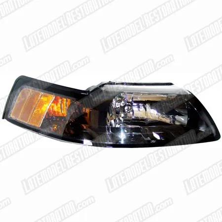

Replacements? I'm thinking:
from Latemodel Restoration.

Yes. Everyone's tastes are different but IMHO, these don't really belong on a Mustang. That's why I provided a link to OE-style replacements. That entire Depo housing is something like $69 from LRS. So for $69 a side you can get back to OE appearance and lighting.
But if you like the halos then by all means keep them and see what you can do to fix the one that's acting up.

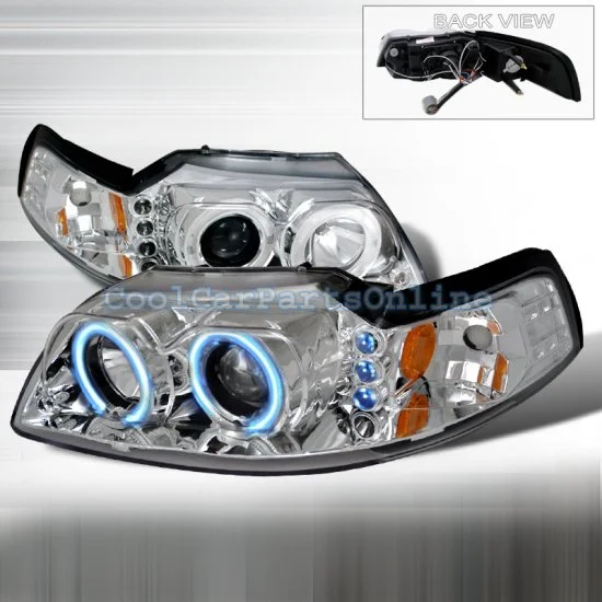

Ok, I looked at the assembly and found they are made by Junyan, who I never heard of before, but anyway, I went to their website and they make replacement bulbs but they sell so many different replacement bulbs that I don't know which one I need. I send them an email asking which ones I need but haven't heard anything back yet.
This is what I have:
Pull the other bulb and look for a part number. If not, buy them in pairs which is preferable anyways else one might be brighter than the other.
Their bulbs are selling for $70 each!! I doubt I will be buying two at a time. I'm thinking it might be a 9007 bulb type, like the OEM's are, except it's a HID bulb. I'm just wondering if these HID bulbs can be bought at a local auto parts store for less.
Ok. Need a little more information here.
First, those housings take an H1 bulb, not a 9007.
Now, you did not specify if you had HID's, which changes the bulb you'd be looking for. If you have HID's there will be ballasts mounted somewhere and usually a harness running to the battery for Hi's.
Standard H1 xenon bulbs can be had at your local auto parts store if you don't have HID's.
If you do in fact have HID's your only option is online vendors. And for that you need the brand of HID kit you are running.
Also one last thing, I've had personal experience installing and maintaining these particular headlights for some customers and take it from me, replace them...soon. The rings burn out rather quickly in some cases and cannot be serviced, the Hi-beam bulb is a bitch to change, and depending on who installed them, the custom wiring can be a problem. In one case I had a guy bring these in, the custom wiring done for all the extra LED's had been spliced using those quick disconnects and plastic quick splice connectors, which led to a small fire in the junction and just snowballed from there.

I did not see a ballast anywhere or any extra wires running over to the battery so it might be safe to assume they are an H1 bulb.
I guess my next question would be: how do you remove/install these bulbs? It doesn't look like the typical setup where you twist a plastic ring and pull the bulb out. From what I can see, there appears to be a rubber boot that can be pulled back and then there is a metal clip of some sort which might be what holds the bulb in place...not sure though. It looks like a bitch to replace even the low beam bulb. If it was the left side that was bad, the battery would have to be removed to get at anything!
