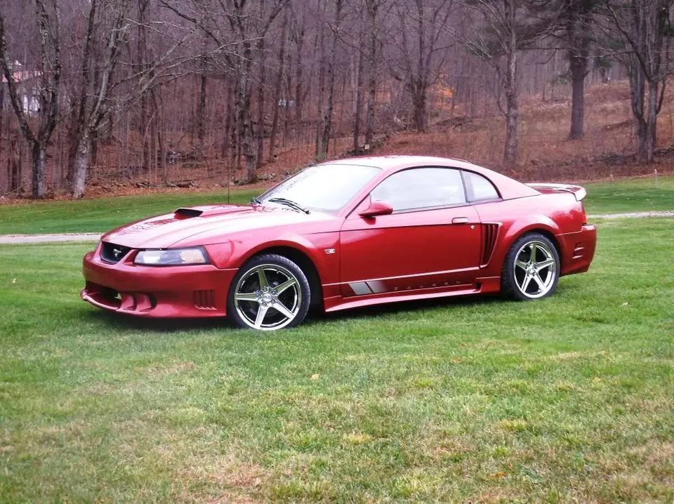

it also has 18x9 and 10 saleen wheels, the car is a complete saleen clone.

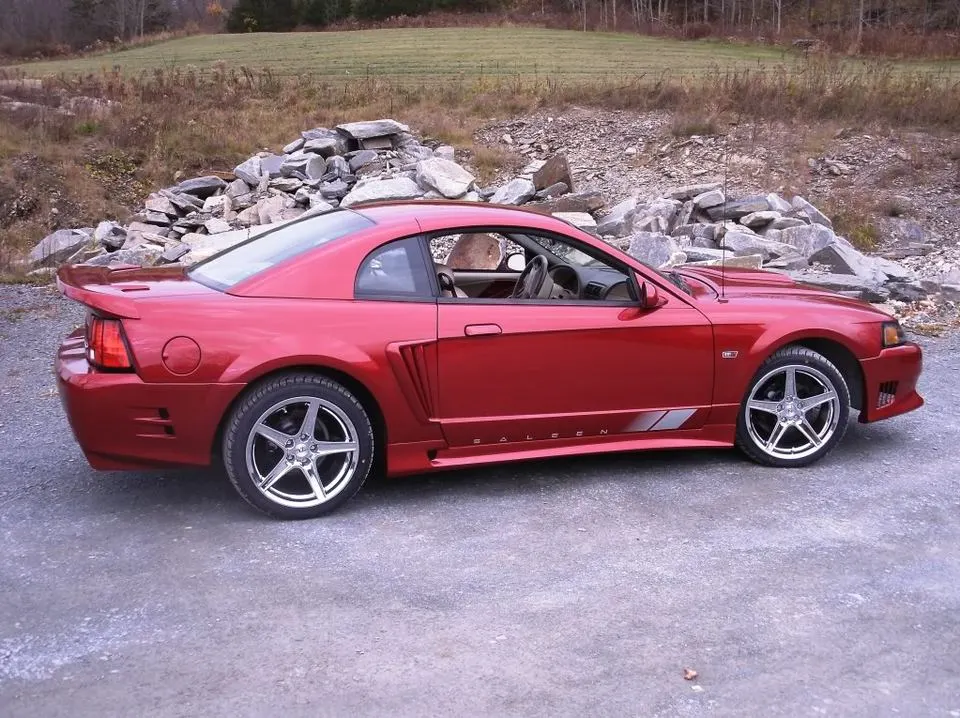

slayerripkdc
Jun 3, 2003
1,341
59
brewster ny
Apr 21, 2010
  • Apr 21, 2010
pics

91green5.0 said:
any idea what a dyno tune would run? I dont really plan on doing any other mods besides the gears down the road.
Less than a hand held. Mean lookin' machine!
