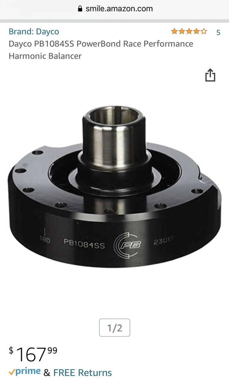

If it’s that old, you may just want to replace it as preventative maintenance. Just replaced mine and there was a huge difference in the driveline vibration and even at idle it doesn’t shake side to side.
here’s what I got after being recommended by one of my favorite members of this forum. It’s SFI rated, laser etched timing marks, and won’t break the bank.

Yeah I agree I’m actually going to take it super easy on the car until I can get a new one. Thanks for the link I’ll look into that one while I wait for parts to come in. My car also does shake pretty bad and I’ve looked at the balancer and looking at it from the front it looks pretty wobbly
I got mine from ford but that was a minute ago. Shop around.
