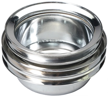

Sorry I forgot to mention I do have the original A/C on the car. So the 2 groove then?
Absolutely not! With AC you must have the third groove, the second one simply does nothing if you don't have PS. This one is chrome, but of course they also come in black:
