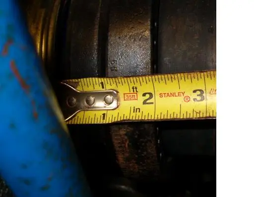

I've always been interested about this balancer, I've been around a lot of vintage stangs and I have never seen a STOCK 302 balancer this big, with the exception if the hi-po 289 which was around three inches wide. Does anybody think it has performance advantage over the thinner units?
Its the stock balancer from my 69 coupe, 302, auto
Good point about rotating mass, especially about switching a manual, iron flywheel for aluminum. The picture I included didn't show the opposite half of the damper which has less material. The picture shows the "counter weight"? But when it comes to the job of a damper, the more surface area to absorb vibration, the better. And that leads to less parasitic loss, better oil control, and a more stable valve train. Which is why the previously mentioned hi-po balancer is so wide, as well as most after market replacements.
Never thought of it that way. I always figured that the size of the balancer didn't matter; just that it balanced out the motor. I am wondering if the reason for the bigger dampaner (and you noted that you showed the counter weight side) is that the crank itself on the hi-po motors was made differently. That way, you would need more counter mass to balance out the motor.
but then again, the size of the balancer would be important with a more powerful motor wouldnt it? If its having to smooth out more "powerful" hits from each piston and the equivalant jerking that the balancer would have to deal with a smaller one would have its disadvantages. (btw, light flywheels only help really low torque motors)
Well, now that I think about it, the balancer is just the fine tunning of the engines balancing. The main counter force action is done by the counter weights on the crank itself, so all the balancer is doing is fine tunning that.
Actually, the hipo cranks were from the same production lines as the std crank, the only difference was they were checked for hardness. The main thing that makes a hipo bottom end better is the thicker main caps.
The hipos had a thicker damper to dampen the torsional stress better, and the counterweight to improve the high rpm balance.

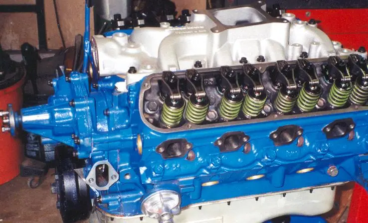

another picture (stock balancer)
I'll see if I can't find another picture of the smaller type along with maybe a 289 hi-po style. There is this business called THE DAMPER DUDES, they rebuild dampers and they are supposed to be pretty good. Ever heard of them?
