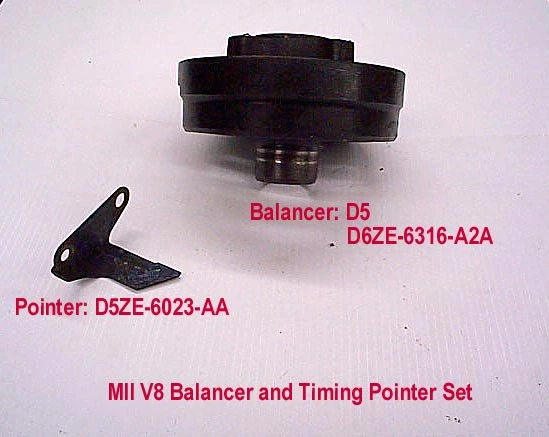

Just about any 4 bolt balancer will work as long as you have it's matching pointer. There are only 3-4 combos up till the early 80s that Ford used, one being the 'casted in pointer' on the 289. Here's a pic I made a while ago with part numbers that I've found factory on the IIs.
