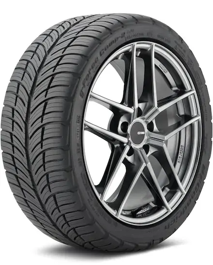

2000xp8 said:
A 255 is a lot of tire for a 7inch wheel.
I remember we used to run bfg drag radials back in the day that size, there was quite a bit of bulging. Looks even worse on 16 inch wheels that landed up with a taller sidewall. Probably why you ate the middle up. Then again drag radials aren't good for too many years in a row before they crack in a northern climate where they aren't stored in a warm temp, so longevity isn't much of a thing.
How often do you drive this car in the rain?
I know the feeling, when i used to run nitto drag radials on my car as a daily driver on the highway in the rain at about 65mph i hear a zzzzzz sound and at cruising speed the rear tires let go and i kept it in the same lane, except facing traffic coming at me. Somehow i made it out of that mess, then i went and bought my old awd saleen explorer.
You may want to look at road race style tires with a 200 or lower treadwear rating that score well in wet conditions.
thats why i want to try BFGoodrich g-Force COMP-2 A/S Plus on the rear 245 50 16 suposed to have great grab when its dry and bite the pavement in the rain really nice.
View: https://www.youtube.com/watch?v=CX3Isr6dwL8
BFGoodrich g-Force COMP-2 A/S PLUS​
Mid-Range
Visit BFGoodrich Official Website
Tire Grade
8.4 of 10
Customer Ratings​
Wet Weather
8.9 of 10
Winter Weather
6.9 of 10
Dry Weather
9.3 of 10
Ride Comfort
8.3 of 10
Tread Wear
8.1 of 10
UTQG​
Uniform Tire Quality Grade
UTQG Treadwear Rating: 400
UTQG Traction Rating: A
UTQG Temperature Rating: A
Mileage Warranty​
6 Years / 45,000 Miles
The treadwear of 400 and the 45k warranty tell me that those tires most likely suck.
Softer tires are better and nearly none of them come with a warranty.
I used to consider it a victory to get to 5,000 miles.
If this isn't your daily driver, i'd just avoid the rain.
Goto tirerack, input your size, then sort by lowerst UTQG to highest. Obviously skip over winter tires.
You will see all the best available. Personally, i wouldn't be buying any tire with more than a 200 treadwear rating.
A 245 is ok on a 7. Still bulges a bit, but a 245/50/16 is surely better than a 255/50/16 (which gets wider and taller).
