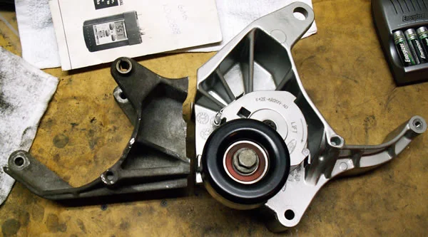

I'm getting everything ready for the engine swap. I removed my smog pump a while back. While taking the accessories off the engine, I just noticed how HUGE and heavy the alternator/smog bracket is. :shock:
Running the shorter belt on my setup has worked fine over the years. So my question is... has anyone CUT their smog bracket off? Or is there an aftermarket bracket I can buy that ONLY holds the alternator? :shrug:
I might as well save some weight and space if I never plan to put it back on the car right? :D
Well because of my supercharger backet, I don't have that issue nor do I want to cut it, but I don't have AC anymore so I cut that bracket down just like your asking. Just another thing to help clean up the look and save a little weight.
I believe I'm running the 89.5 belt. It's been a while so I may be off.
Mine is very close to that. I have the actual belt number written down in my car. It varies about an inch depending on which underdrive pulleys a car has, and how many/if any. :nice:
BTW - bracket is now cut.... Going to clean it up and paint it with alumi-lite as soon as it warms back up around here. :D
You'll be fine. I cut mine 5 years ago b/c I didn't want to run an eliminator kit and no problems.
Thanks... a little late to turn back now. :D
