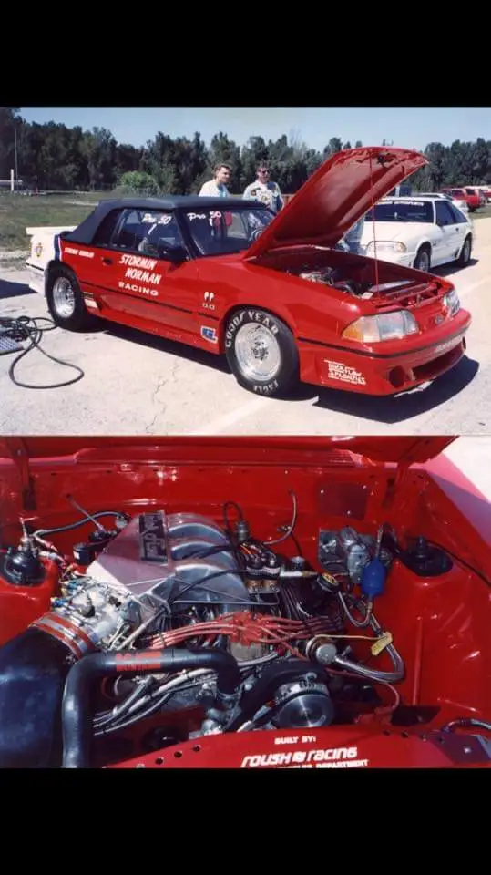

rbohm Founding Member Apr 12, 2002 6,698 550 204 tucson,az Jul 13, 2015 #2 Jul 13, 2015 #2 that looks like a fabricated upper intake. but i have seen the trick flow upper intake that used two throttle bodies, the runners were much longer and as i recall both throttle bodies faced forward.

jrichker StangNet's favorite TOOL In Remembrance. Thank you for your contributions Mar 10, 2000 27,512 2,813 234 Dublin GA Jul 13, 2015 #3 Jul 13, 2015 #3 Are you going to have 2 MAFs? Reactions: mikestang63
mikestang63 SN Certified Technician Aug 27, 2012 11,606 8,859 214 In the garage Jul 13, 2015 #4 Jul 13, 2015 #4 complete waste of time IMO. Just step up to a larger TB Reactions: A5literMan

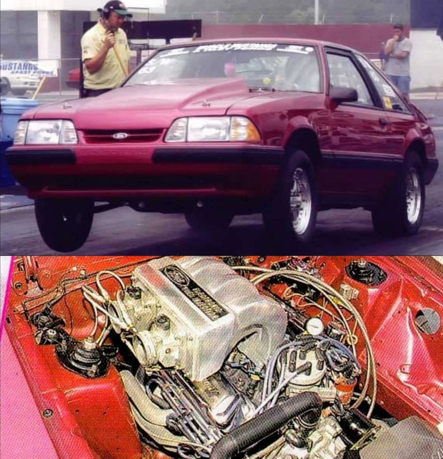

DAJ352 Member Mar 12, 2019 74 16 18 Gainesville, FL Jun 29, 2019 #5 Jun 29, 2019 #5 90sickfox said: Click to expand... 90sickfox said: Click to expand... Toby Gant 79 Mustang Stock 87 5.0 ShortBlock, J302 Heads, Ultradyne Cam, Custom Fabbed Truck Based Intake By Toby & Pete Incaudo, Twin 60mm Throttle Bodies, Dual NOS Foggers 125hp Single Stage, Stock 19lb INJ's, Stock 87 EEC-IV, & MSD-6al. C4 Trans Toby - We went 9.90's pretty consistent. We were the 3rd to go in the 9's. Norman, Wolf, us. But alot of guys did really soon after also Reactions: Noobz347

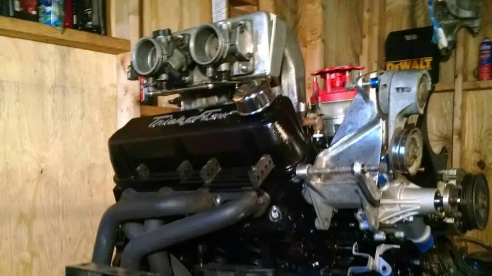

90sickfox Wasn't a pretty sight...and I've got big hands SN Certified Technician Mar 2, 2015 6,945 5,816 213 Jun 29, 2019 #7 Jun 29, 2019 #7 That was an old nitrous intake of mine. That thing was awesome...but sold now.
