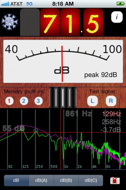

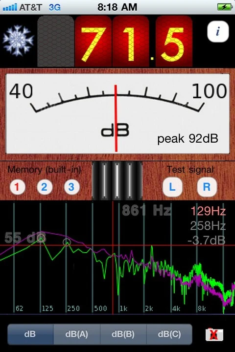

Here's the results from my Magnaflowed G8. It droned like crazy at around 1900 RPM, as seen by this screen shot from a sound meter app on my iphone. That big hump in the 125hz range is the drone:

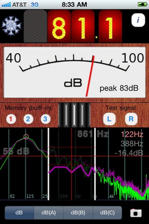

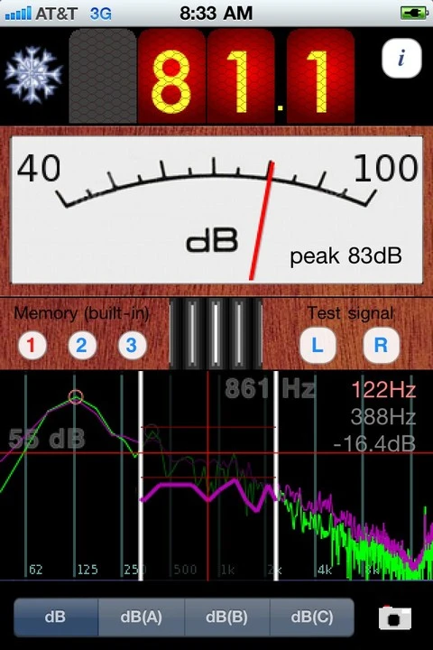

I did the 1/4-wave tubes and the difference is huge. I don't have any sound files, but the meter tells the story: Same RPM, same stretch of road, same time of day. Look how much smaller that hump is, and look how many fewer decibels it's reading:
The drone has been virtually eliminated, and I'm a happy camper.

@MFE92
Supposedly every 3 db. drop reduces the sound level by half.
Example:
Sound level 100 reduce by 3 db.
New sound level is 50
Sound level 50 reduce by 3 db.
New sound level is 25
Sound level 25 reduce by 3 db.
New sound level is 12.5
With that in mind, your almost 10 db. drop is a tremendous difference
