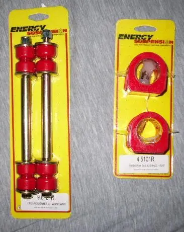

By disconnecting one (or both) of the end links. You'll need a pair of wrenches, I don't recall which sizes. One wrench goes to hold the top bolt, while the other (or ratchet) removes the bottom nut. It might have a little tension on it, so don't care yourself *****less while removing it. :) Replacing it is just as simple. In case you didn't know, end links are in the pic on the left.
