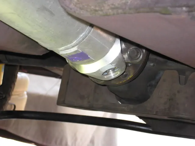

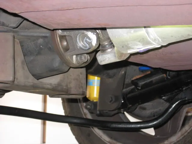

Now, I was taking a look at my driveshaft and noticed while the pinion flange has a faint yellow mark aligned with the purple dot on the DS, there is also some white paint on the rear u-joint.
Does it look like the driveshaft is installed correctly?
