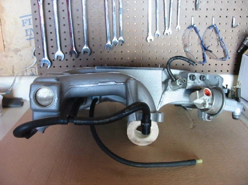

Question #3: The PVC valve is on the end of a hose, but there are two other ends of hoses of that same connetion I can't figuere out where to connect. The whole thing has a T shape to it.

Question #3: the T hose should go to the far upper right corner of the upper plenum.(the point of perspective is that you you looking at it from in front of the car)
PCV-------|-----------Far corner
under the upper plenum but connected to it.
I stole this pic from RIO5.0 I hope this helps
