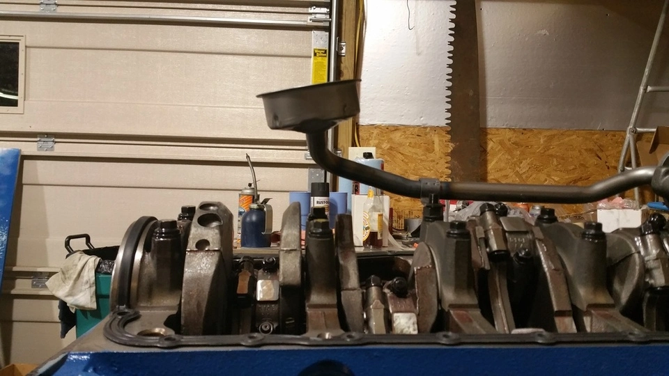

New question. My pickup tube is only .05 in from bottom of pan. My book says to make sure its within a half inch or .5 in. Is there such a thing as too close? Do I need to bend it again?
stang89bidges
Advanced Member
Mar 14, 2014
727
144
74
Fort Worth Texas
Apr 27, 2015
#247
  • Apr 27, 2015
  • #247
Forgot to add the gasket, with my 1 piece oild pan gasket its now .15-.16 clearance. I just found this on canton website:
Canton Racing Products - Oil Pan Accessories Tech
I guess its back to the blow torch...

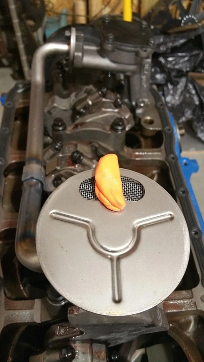

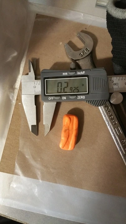

Take a piece of modeling clay and cut a piece about 3/8" thick. Lay it ontop of your pickup screen. . put down your pan gasket. lay your pan ontop and put some light pressure on the pan. Remove the pan and see measure the thickness of the clay. It helps to spray the clay with pam so it doesnt stick.

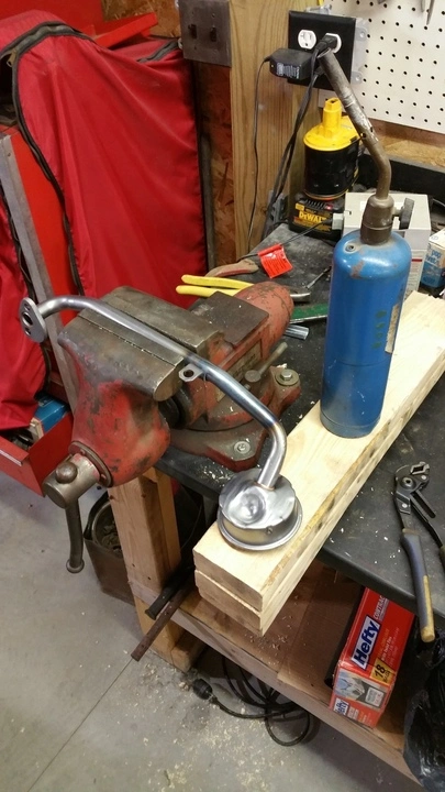

Modifying the pickup.
After a couple times of heating and bending the pickup I got it close enough. I'm only nervous about the angle at this point but the lowest part is the screen so I'm leaving it.
Canton website says between .312-.375 in. The more I bend it the worse the angle gets so this will have to do.
