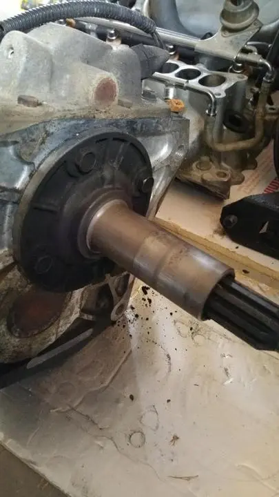

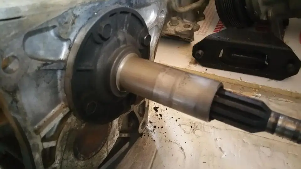

So how about this picture, it's my bearing retainer. Since the PO installed a newer Centerforce clutch I'm assuming he also upgraded the stock bearing retainer on the tranny?? I can't tell, don't know what the original bearing retainer looked like. Need help identifying it please.
Original or Steel Bearing Retainer?

A magnet applied to the place where the throwout bearing slides will tell you quicker than anything else. Steel attracts a magnet, aluminum does not.
