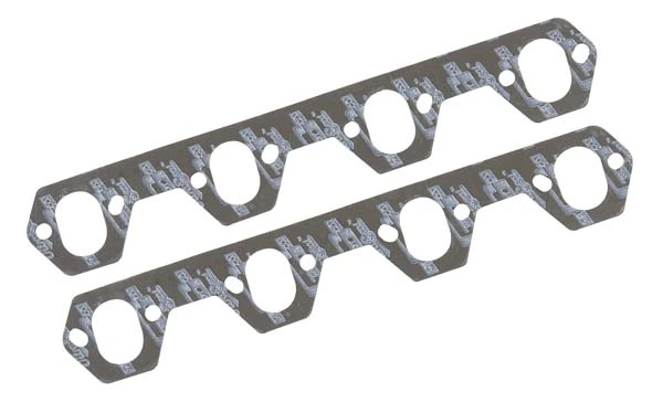

these are the gaskets i used with aftermarket headers mr. gasket #5928 click on link http://performanceparts.com/part.php?partID=37973 the gaskets supplied with my headers gave me problems so i switched to the gaskets in the link and in pic. below.. i have had no problems so far but i also installed locking bolts when i installed these gaskets...but with aftermarket headers i think you need the oval hole gasket not the felpro 1415 gasket i think that gasket is for factory headers....you can order these gaskets at any local autoparts store just give them the brand and part number and they will have them overnight in most cases.
