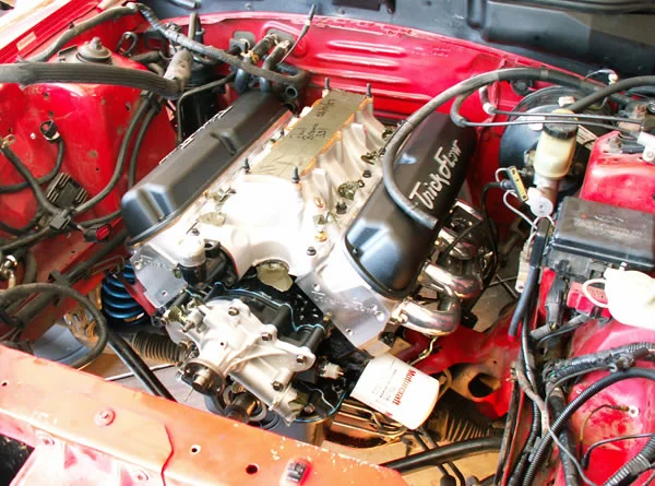

Ceramic-coated BBK shortie unequals FTW!
