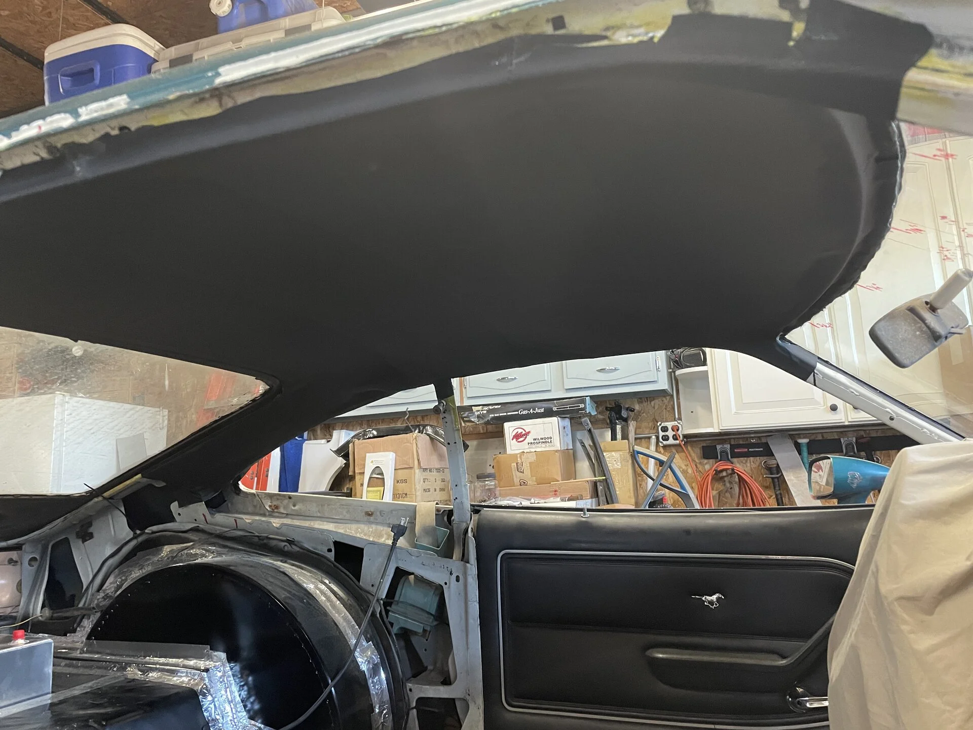

Well, I finally did it. Went pretty good with all of the advice I received on this thread. I’m very pleased with how it turned out. Did not need the clips at all. The weld wood landau top and trim glue is really good stuff. But I did learn one tip for others who plan to do this. I would only put the glue on the very outer lip of the edges and on the outside of the pinch welds. This allows you to pull the headliner tighter without the glue catching to soon. Also if you glue further in, the headliner wants to follow all the awkward lines of the roof supports instead of hanging smooth. Other than that, it wasn’t to bad of a job. I would definitely do it again if necessary. The results are well worth the effort.
