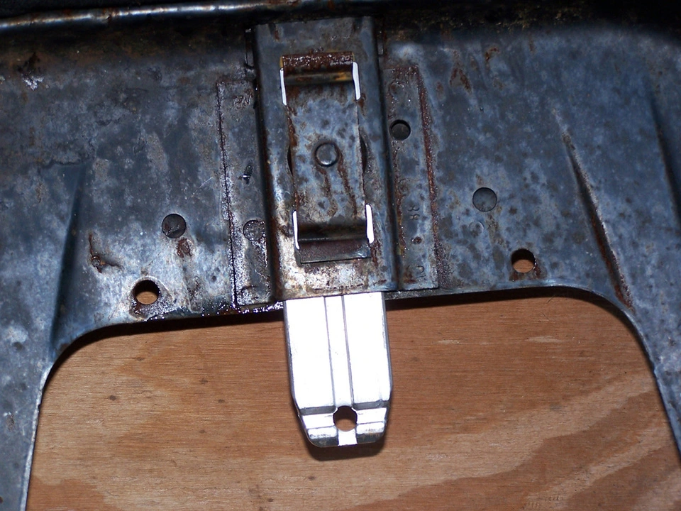

I unziped the seat cover on the back of the seat. reached way up and on the front side (around where you shoulder blades would be) pulled the mettal tab with a small screwdriver and pulled the headrests up....I'll look for a pic to help you see the inside of the seat.
