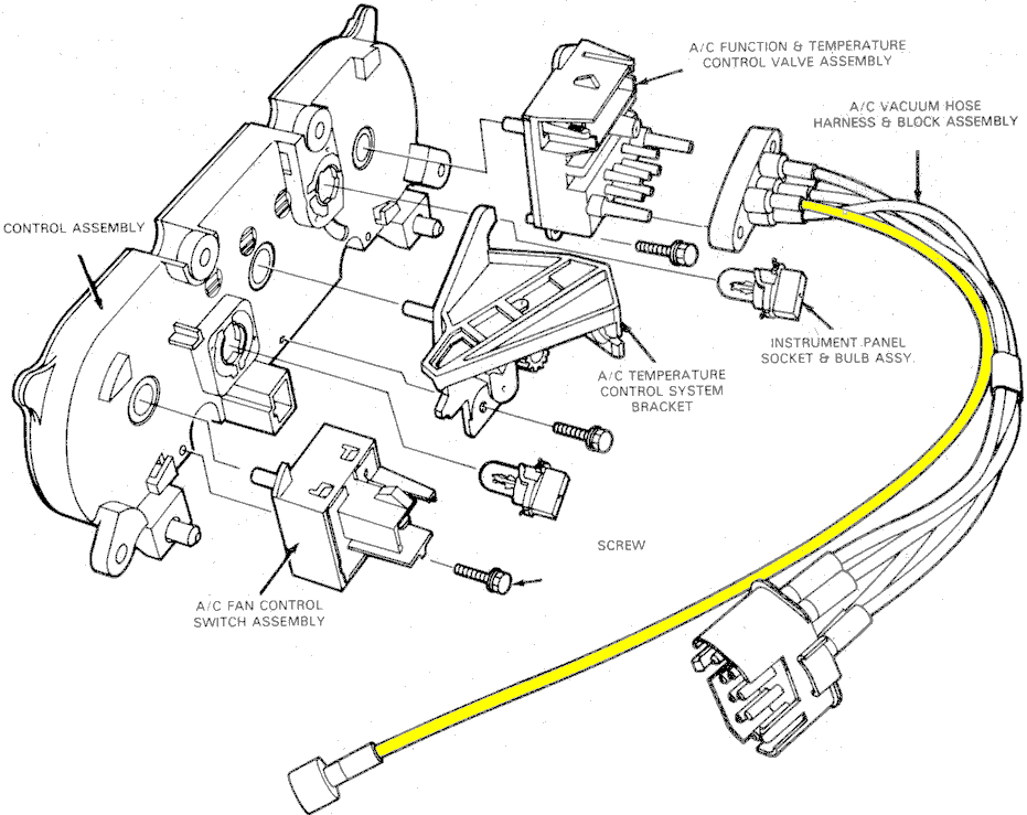

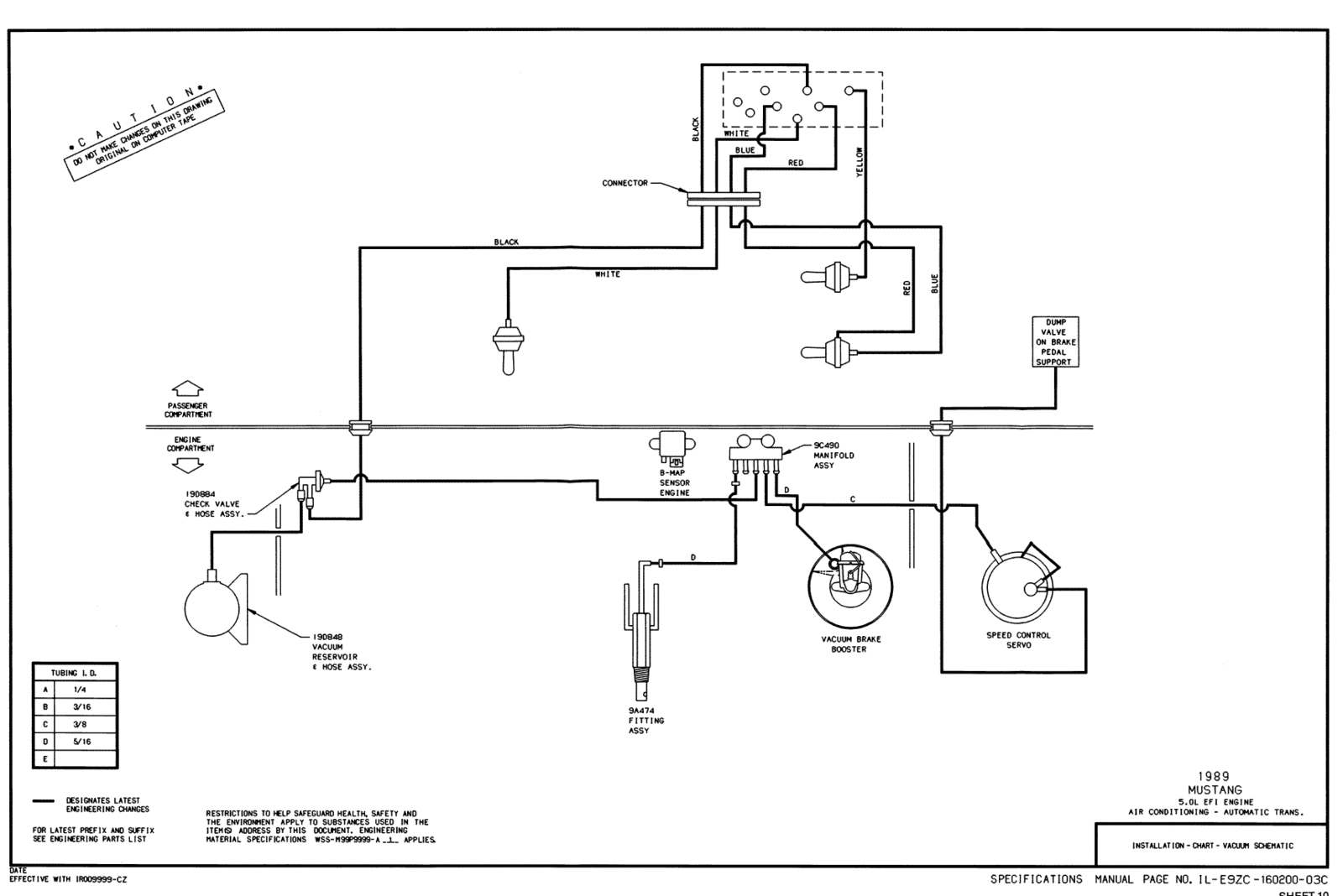

Next inspect the heater controls to make sure the air temp flapper isn't stuck so that it sources air from the A/C-vent side. Check the vacuum lines to make sure none of them are cracked or broken.
Note that both the images are reduced size. Clicking inside them after they are opened will give you the option of enlarging them.
The diagrams are for an 89 Mustang, but shold be similar for 87-93 model years. It is a good idea to use the sig under the user control panel (User CP) option. It allows you to post your car year & mods, which help greatly when troubleshooting things. No, it is not there for us to snoop and see any "Secrets" you have hidden away under the hood. Be a good stangnetter and update you sig for future reference & don't keep us guessing.
