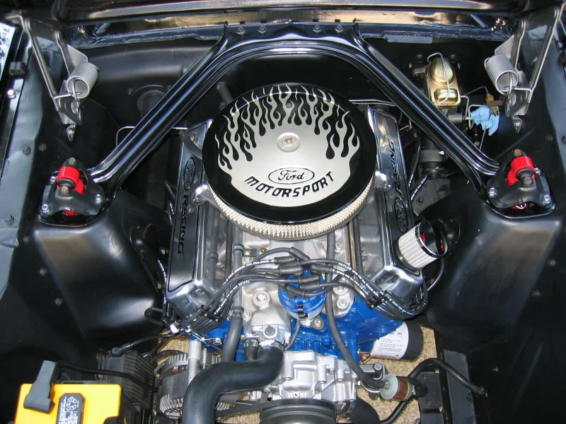

I did a single aluminum pipe for the front line on my Stealth intake. It has a rear water cross-over so one of the two hoses connects back there. Here's the only picture I have handy showing it. I think I got the pipe from McMaster, but don't recall for sure. I just sanded it with some 1200 grit paper and sprayed it with clear.
