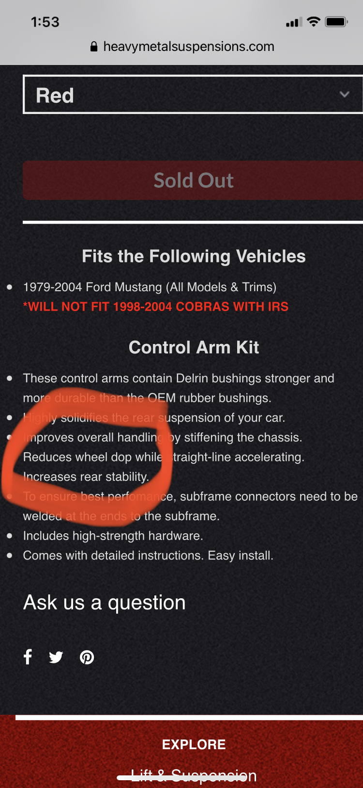

Too bad they are out stock...... they reduce the dreaded “wheel dop”
And while I don’t really care howpeople write or spell in their posts, I find this to be a quick glimpse into the type of company you’re dealing with when they can’t get their website correct! JMO
