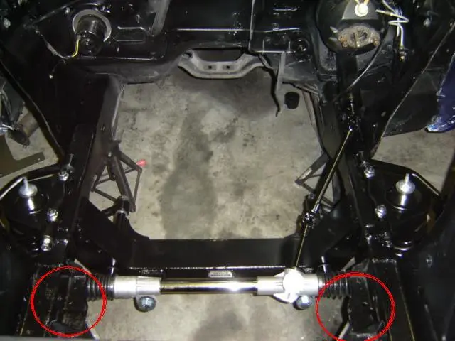

Hey all,
So I have been working on getting my Heidts kit installed as the job/OT allows time. Everythign has been goining smoothy, I'm real impressed with the quality of the kit.
I got the Deluxe kit (tubular A-arms) and I am having an issue with figuring out how to mount the sway bar. The included instructions aren't exactly helpfull for the swaybar. I plan on calling the Shop I got the kit from on Monday to ask about sway bar mounting but I know a few people on here have used the Heidt's kit.
Does anyone have a picture of how the sway bar mounts? I cant figure out if it goes over or under the rack...then there is also issues with the swaybar wanting to hit the coil springs. There were a few other brackets included with the sway bar that I cant really figure out how they incorperate into the mix as well....basicly, a picture of it installed would really really help me figure this out. Anyone? :D

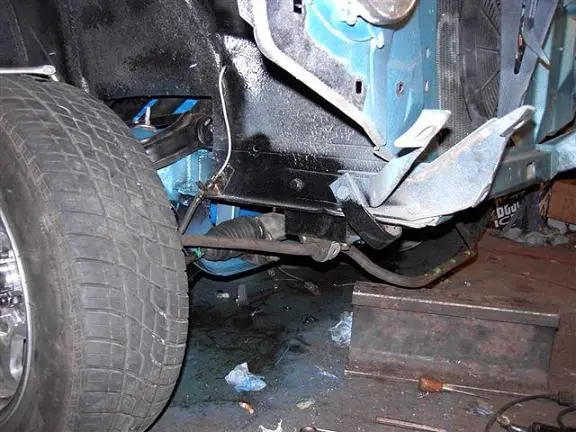

LUCAFU1 - I was hoping the MII sway bar would nicely use the original sway bar mounting location but it doesn't immediatly appear to do that. the instructions give a measurement from the front of the crossmember to the rear-most sway bar mounting hole and the set of original holes are too close to the cross member by about a half to 3/4 of an inch, I thought maybe this amount of space could be fudged with slop in the mounting brackets but it doesn't look like that is possible.
ashford - You say factory sway bar? I still have my factory sway bar...I hadn't tried using it. I bought the swaybar that Heidts sells specifically for the MII..but either way, it looks like you have the bar routed over the top of the R&P. Are those frame mount locations factory as well? I've never taken a look at what the mount points look like on a falcon, what's in your picture is definately diffrent than my 67 Mustang at least.

i meant stock mII swaybar and crossmember,sorry. falcon suspension is almost identical to the mustang. same contol arm and shocks. shock towers are slightly smaller on a mustang and have different radius rods.
