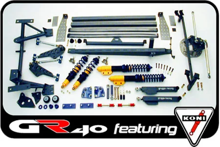

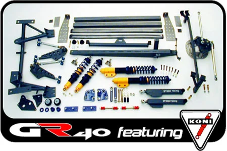

What about Griggs Racing rear setup?
Front and rear kit = $9,769.05
http://www.griggsracing.com/product_info.php?cPath=20_1080&products_id=505
Rear only = $3,104.60
http://www.griggsracing.com/product_info.php?cPath=10_1030_2065_3960&products_id=447
I wish I could afford it, Griggs racing is a tried and true setup put to the test on the race track.
A torque arm/watts link combo is arguably the best setup for road racing.
Now if you only plan on drag racing then this probably has no interest to you.
