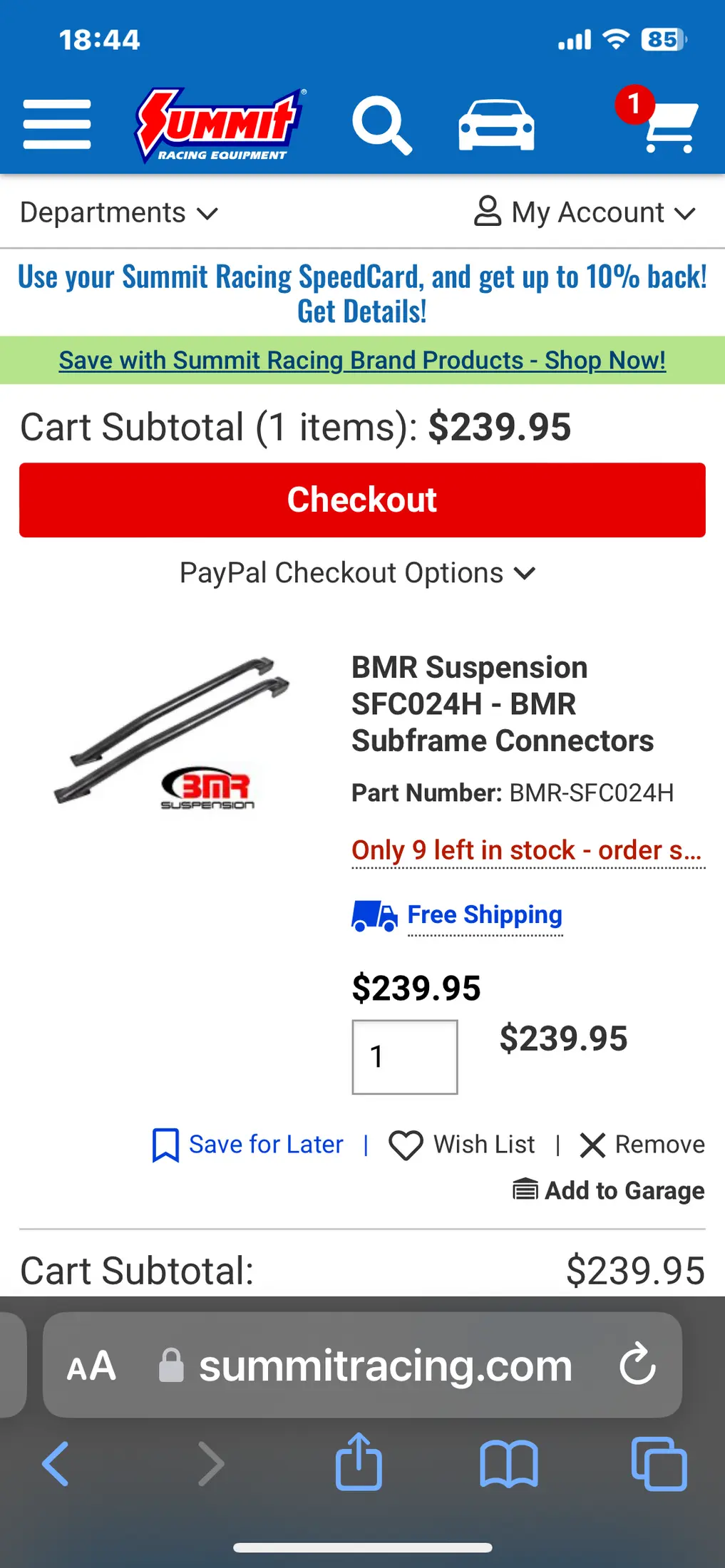

Hi all, I’m looking to do my first mod on my 89 LX 5.0 convertible. A few here recommended sub frame connectors to stiffen up the ride. My mechanic said the same thing and flowmaster 40 series to make it sound the way it’s supposed to. Can anyone send me links for which ones to buy? Mechanic told me to use summit racing to purchase them from. Just want to make sure I buy the right ones. Came across these.

You'll be better off using subframe connectors that have a crossbar that bolts under the seat. I use Stifflers subframe connectors (and their FIT System) on my 2000 GT convertible autocross car. I've been very impressed with the quality of every Stifflers part I've purchased. The Stifflers subframe connectors are also much less expensive. See the link below. Make sure to read the note about 1983-1993 Convertible models needing "brace modification."

I saw those on summit racings site but they didn’t have them in stock. I will get these. What does brace modification mean? Will my mechanic have a problem installing them
