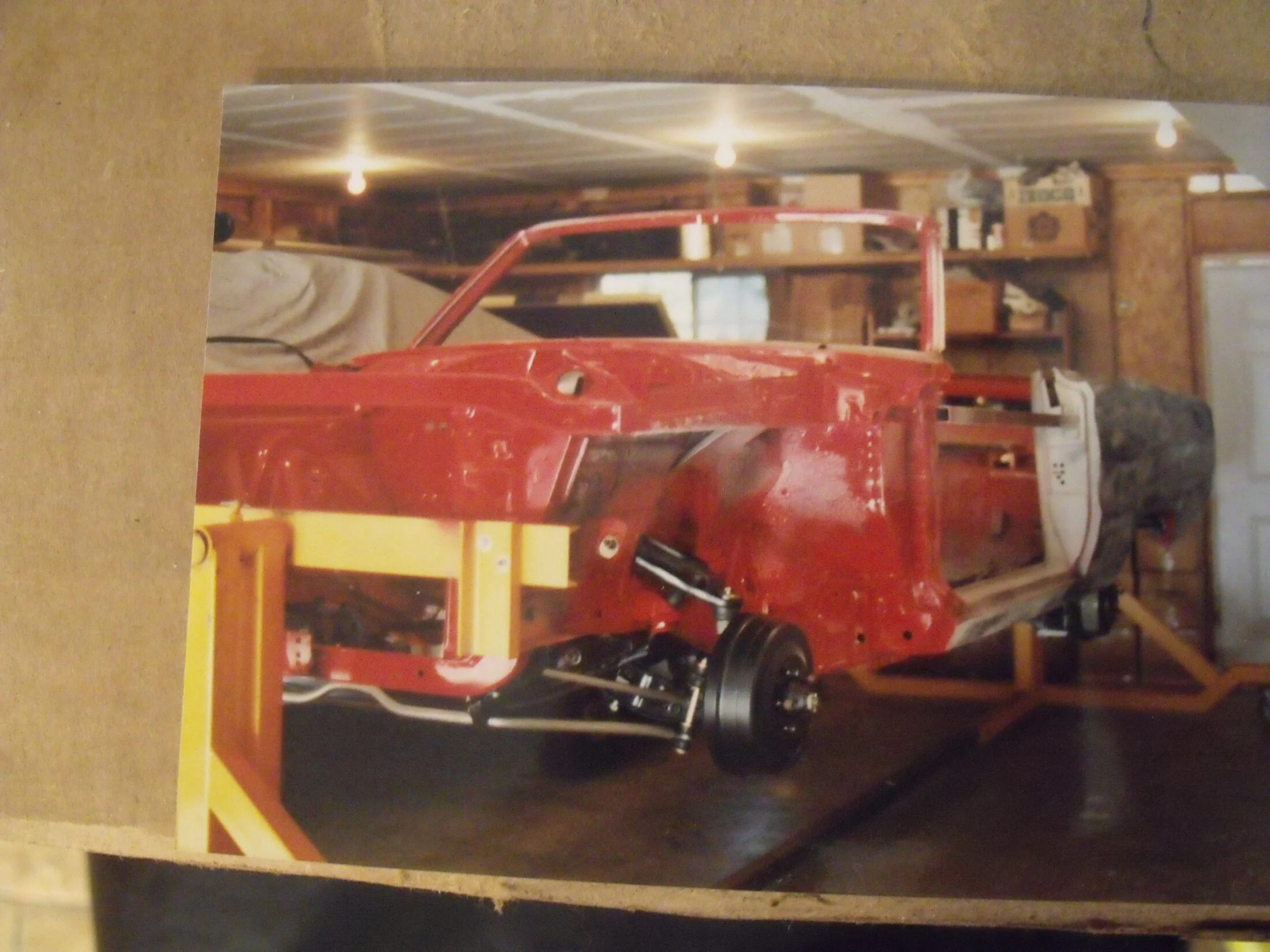

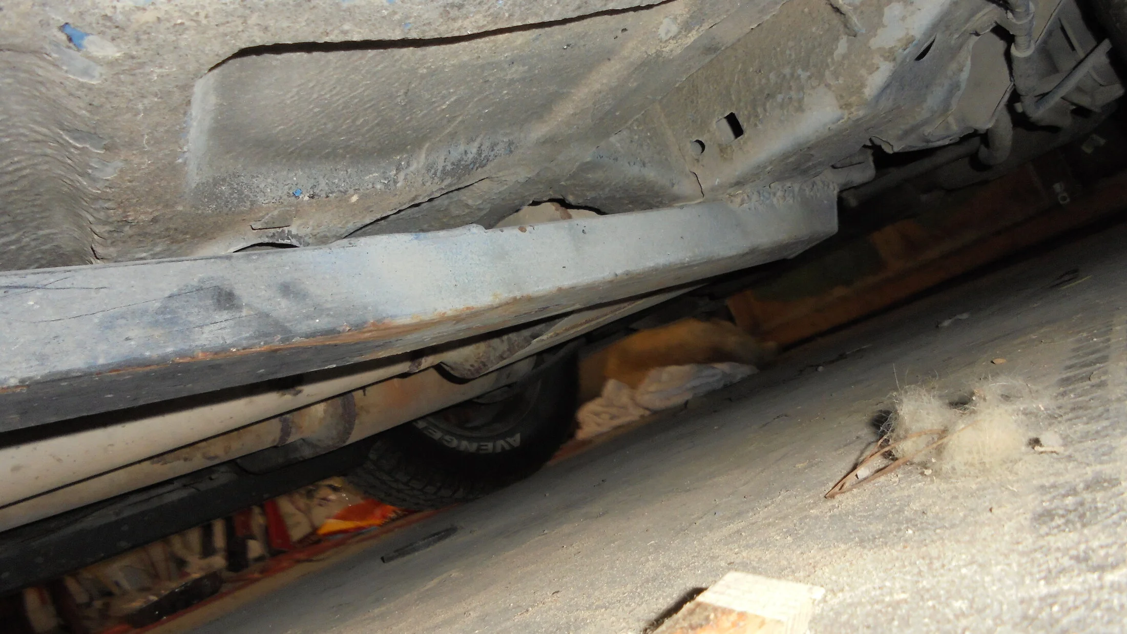

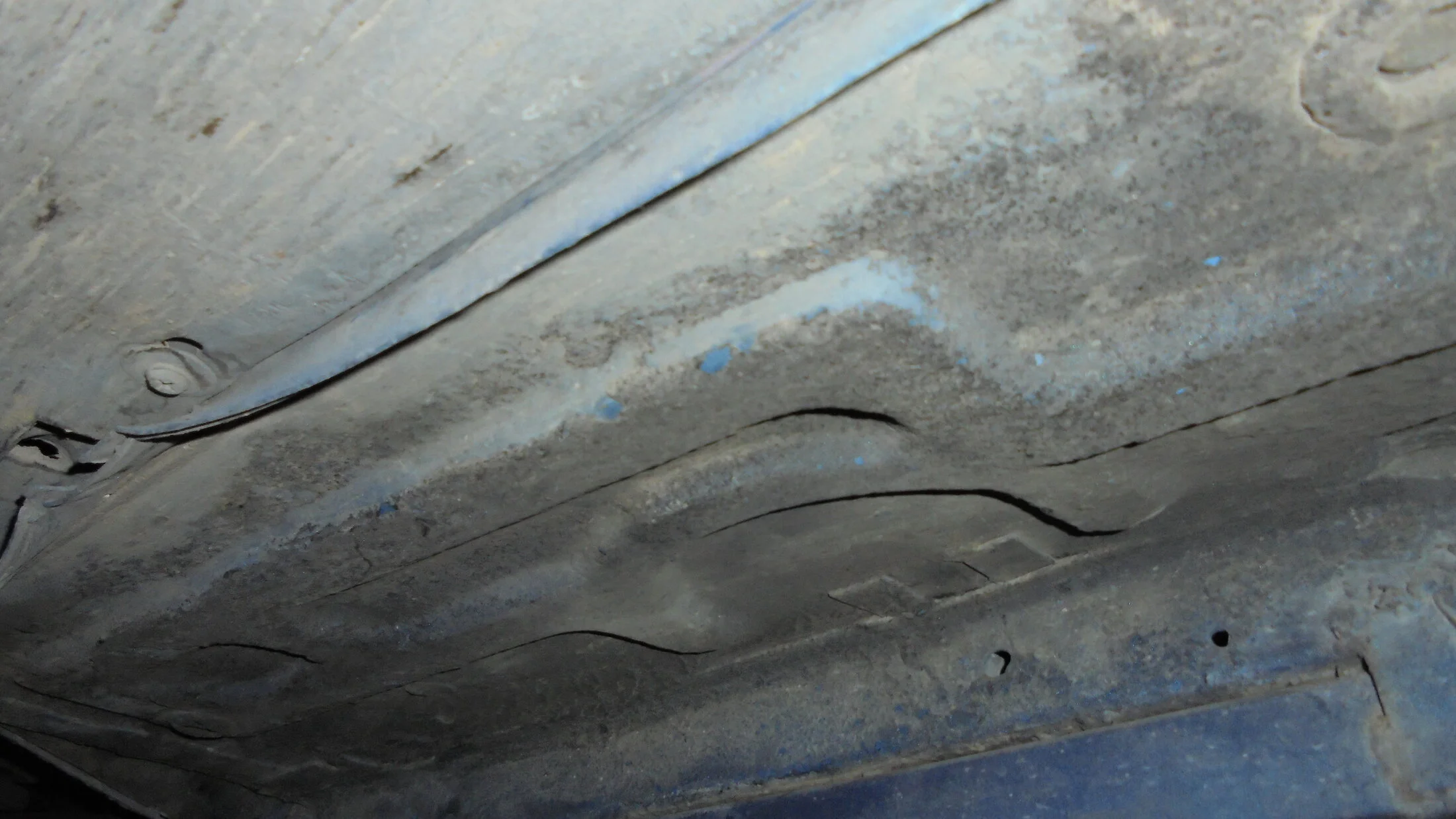

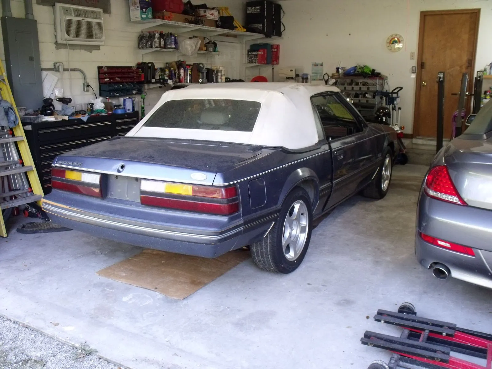

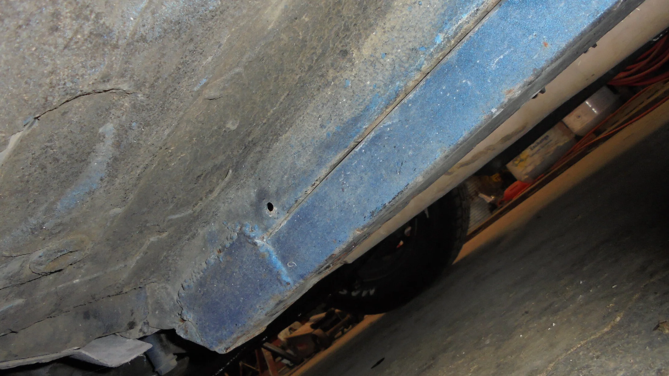

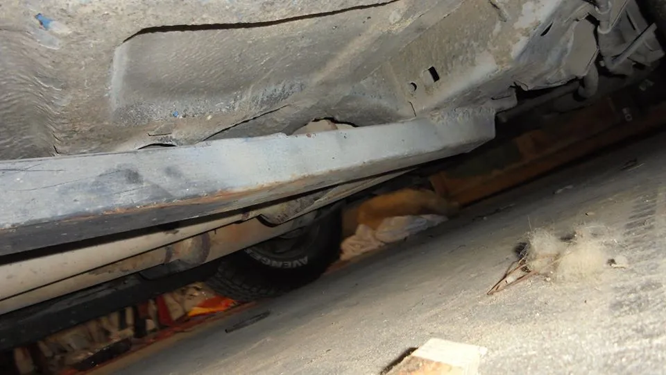

mine came from american muscle if i remember correctly, im not the best welder but they have done good for years...

Sn95 convertibles come with bolt on subframe connectors, and they are a much stuffer chassis than a fox due to improvements in Manufactuing methods, but even the SN guys say that taking the bolt-ons off and putting MM full lenght in made a huge difference.
Reactions: limp
