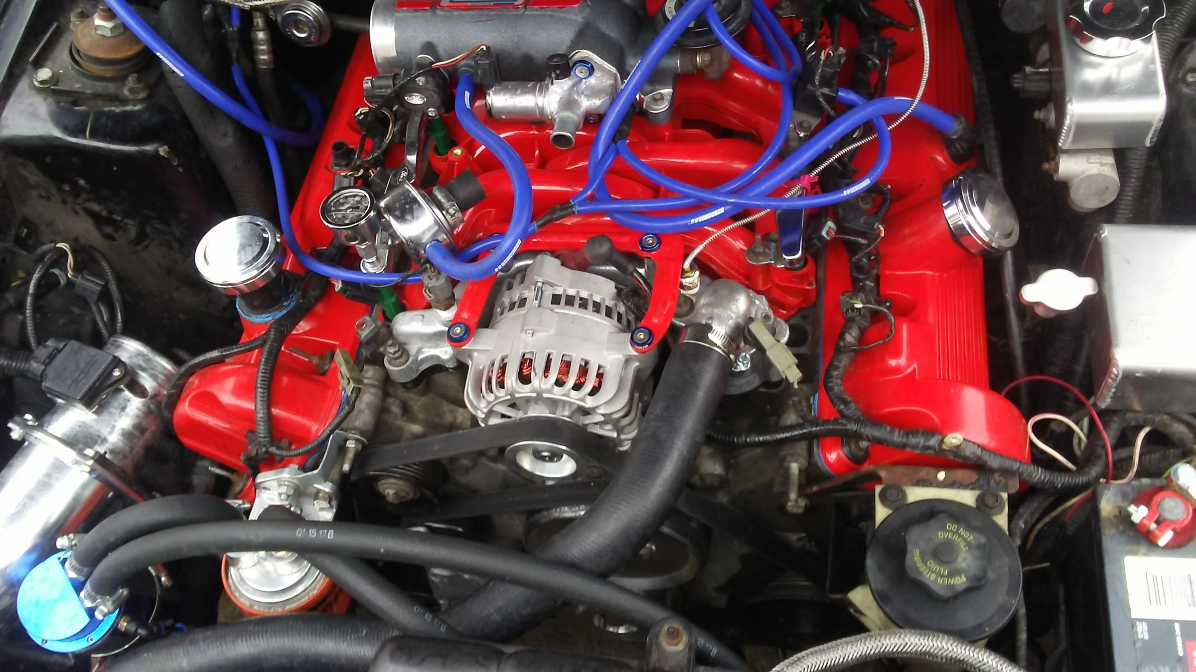

Well finally today got back to Joe's 2000 vert gt and Yes two of cylinders had Lotta fuel in them!!!! Is the 325LPH pump to much? The 42lb injectors and pump went in with the introspection of the 92 r 93mm turbo we're debating on also going in the mustang and running Low Boost untill the motor was done! We've been second guessing that idea the more we run the car! The last owner did some I don't know let's say Crazy work here we Have Not hit the shut down so far up two 148mph with pedal and rpm yet to go the motor has oil fill caps on both valve covers the sensors are not hooked up but it has knock sensors and cylinder head temperature switch! We haven't been able to get a clear definitive view of the block numbers!!!! The mustang we've been calling the MurderStang just keeps getting better!!!
