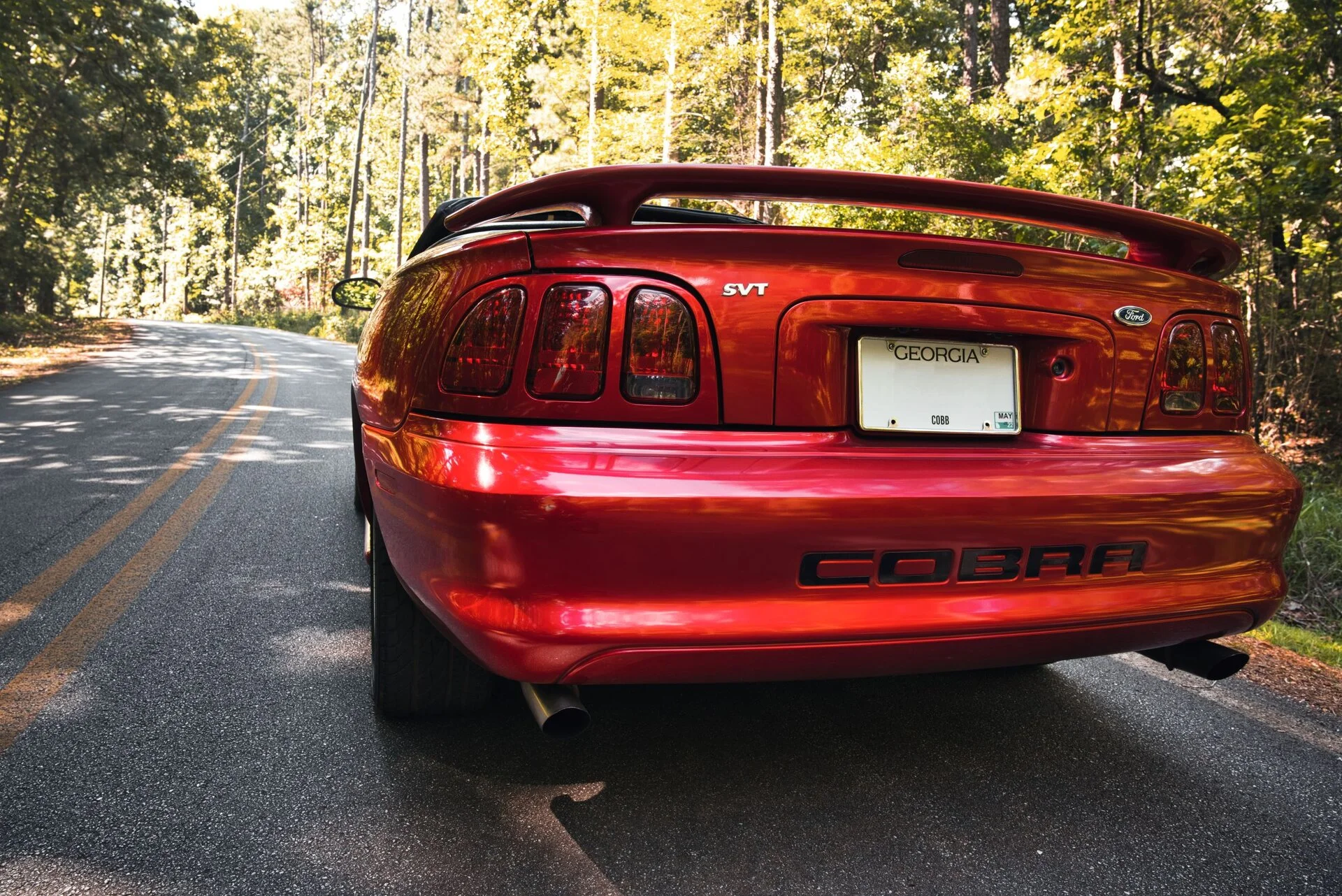

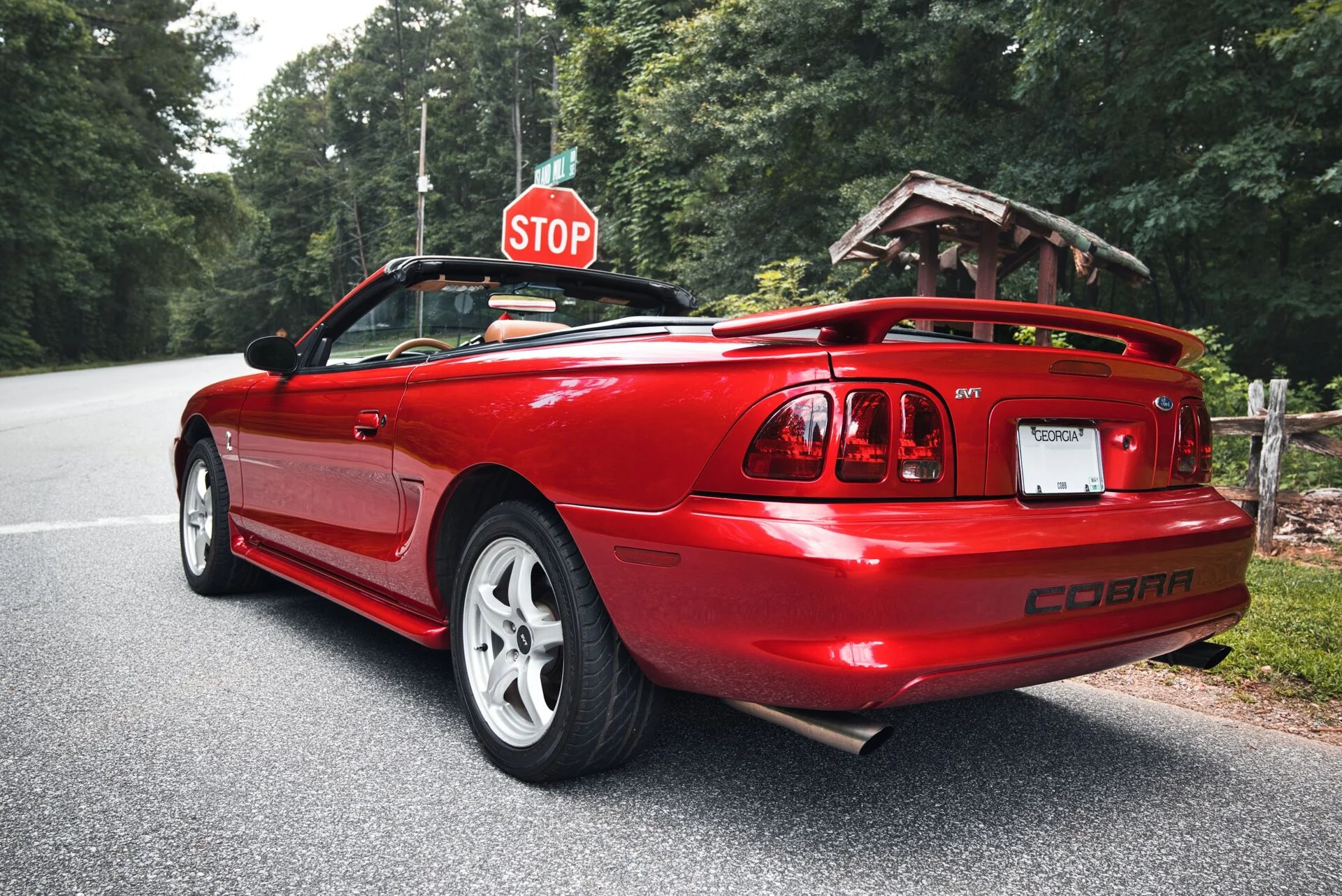

Look forward to the journey! Here's a couple shots of Scarlett ;)
