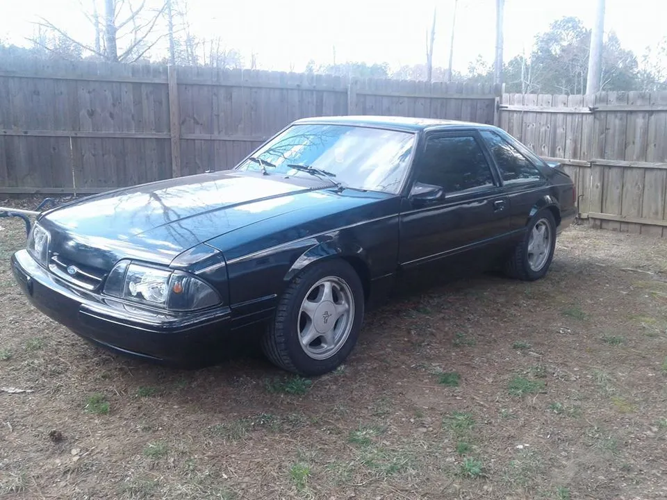

Im new and looking to build me a nice hot rod ! Any ideas were to start will be appreciated !

If thats your car it's looks like a good start, lowered? Done any mods to it yet?
