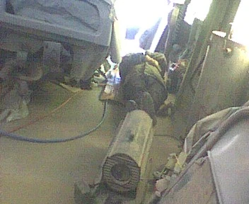

I may or may not be posting in the right section. Coach me on this site if neccessary. Every Forum is different. I'll be posting pics when possible. My little $25- digital camera is not very good. Here is a pic of the EGR delete. I found some info already about what value of resistors to use to make the ECM think that the EGR is functioning properly. Til later, :)

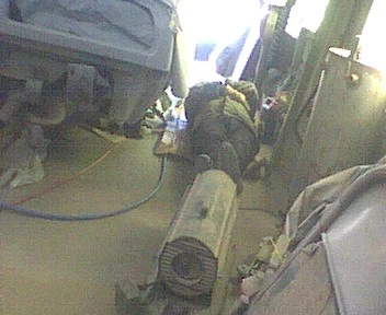

BUSTED ! Sleeping on the job again..."Hey, It's lunchbreak and my feets is cold..."

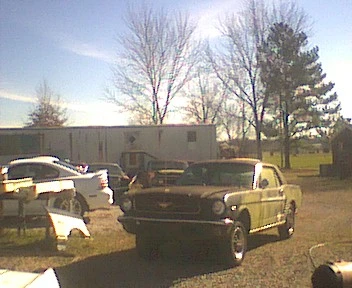

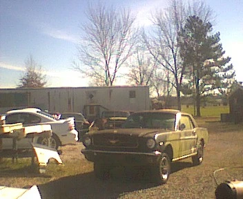

Here is a pic of the donor Mustang

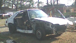

This was one of my customers cars.
It was always well maintained. I bought it after he totaled it

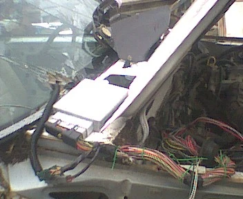

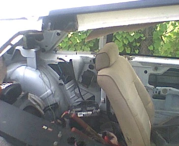

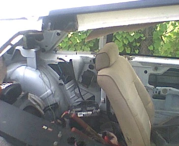

The car was hit so hard in the right side that the ECM wouldn't come out the "normal" way
I'm using a sidecutter or some woud say cutoff tool to get to the computer
I think I got it

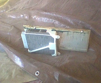

out it comes

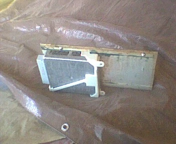

main ECM connector, for those who havn't seen one before
now the computer is laying on the cowl, reconnected. The harness that runs from the ECM towards the column and air bag module is now running through a hole in the windshield for the moment

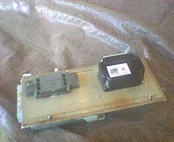

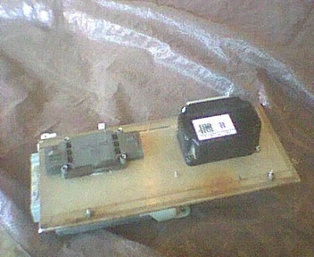

Electronics board
I'll start a new thread soon with the 1965/2300 build-up. Guys, let me know if there is a better sub-forum than this one to post it in.

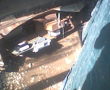

Here are a few pictures of the electronics and the dash where it will be mounted. You'll see in the near future that the engine/wiring etc., will be the easy part of the mod/restoration. The convertible was sitting in the dirt when I got it. It practically will be totally rebuilt structurally, metalwise. I started working on Mustangs in 1976. I have a little experience, and still learning everyday.
Anyway, here are the pics:
EEC/ECM mounted on the bottom of the board, relay box and DIS module on top

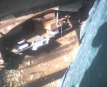

board mounted in '65 Mustang dash, glove box area. ECM nestled up in the curve of the dash. I'm real happy with the "fit" on the first attempt. I'll know soon if there will be any "RF" interference between the EEC and the DIS module. I'm leaving a few feet of wire on the DIS module in case I have to move it away from the computer
I'll post some more pics after the weather gets better. It's abnormally cold here in north Alabama and the project is currently being worked on outside. Til later:flag:

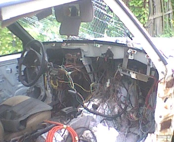

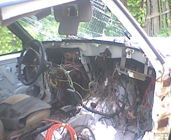

I happily got the electrical system re-routed in a rough sort of way. There are about 50 wires now that will have to be made longer or shorter. I was showing it to Mark the last time he was out and I kind of missed his question the first time around. I'm not so much trying to eliminate any sensors or systems other than deleting the EGR part of it electrically and mechanically. Actually the challenge was removing the "computer" harness from the main harness. Unlike the early computer controlled cars/engines that had a seperate ECM harness from the main harness, the "93 4 cyl Mustang had just one, big, messy harness. I sucessfully seperated the computer harness out of the main harness and over a period of 2 to 3 months and a whole lot of coffee, did this without letting out any "magic smoke". I've got the car back at the shop now and have left the battery hooked up for almost 3 months now without any electrical problems or dead battery syndrome.
As you can see from the picture it is quite a "nest" of wire and this doesn't include the 10 or so pounds of wire and instrument cluster that I deleted. The starter solenoid is mounted on the inside of the cowl and when it is installed in the '65 mustang will be located in the righthand torque box near the starter accessible from the inside of the car by folding back the front passenger carpet and removing an access panel to get to the solenoid.

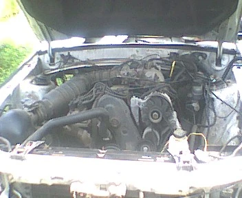

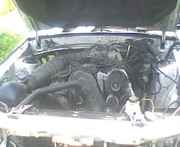

The engine compartment area is starting to look cleaned up a bit without all the wires running to the DIS module, relay box etc. When I install the headlight and other harnesses in the '65 I am going to route them through the frame rails to kind of "hide" them too.
