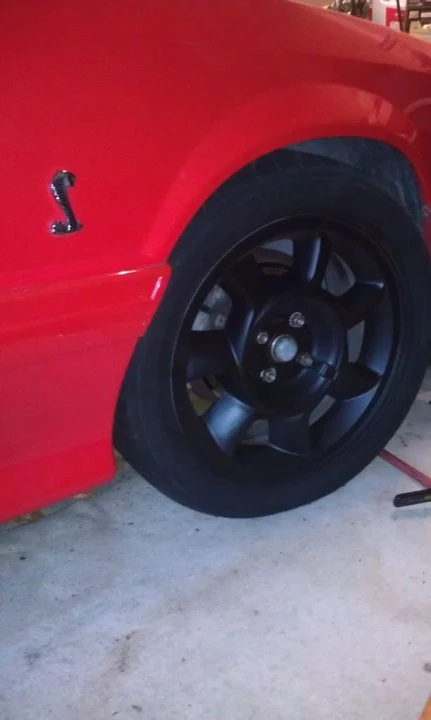

Thanks for that link. I just hit him up and hope to hear from him sooner than later. But while I have been waiting around for replies and trying to figure out what to do suspension wise. I shot my rim satin black with some plasti dip. I think it gave my car a much needed new look. I dig it. What do you think?

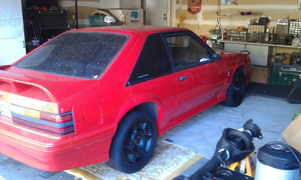

And to all the sticklers out there. Sorry about how dirty the car is. It's been sitting for a while but I'm getting it all cleaned up and detailed slowly but surely.
I really liked the car with the stock colored polished wheels...not a huge fan of the black. BUT, it's your car so if you like it then rock on!

O... I don't actually plan to paint these wheels. Just messing around with a temporary new look. I'm sure Ill go 5 lug one day but that's not until I need more traction for all the power I don't have rite now lol. Just out of curiosity what are the widest tires you guys have run on a stock rim? I got 255s out back rite now and would like to go to a 275 but people don't suggest it from what i have read. But then again I have seen it done and it doesnt look horrible.

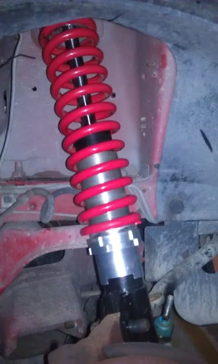

Well I found out the spring rate of those springs is 300lbs which is good according to MM and the shop in my town. I'll be picking up some MM rear springs and some caster camber plates also so the install should be happening this weekend. Can't wait to see the new look on my ride. Then once money allows I'll be getting the MM lower control arms that are the weight jacker style along with a panhard bar.

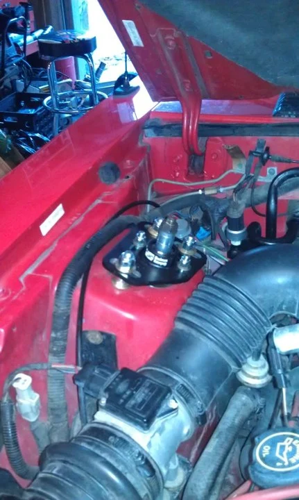

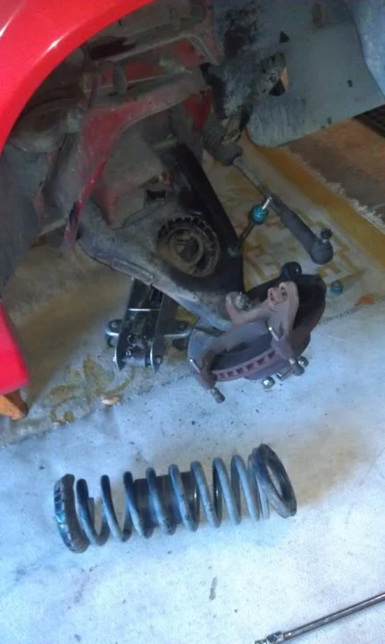

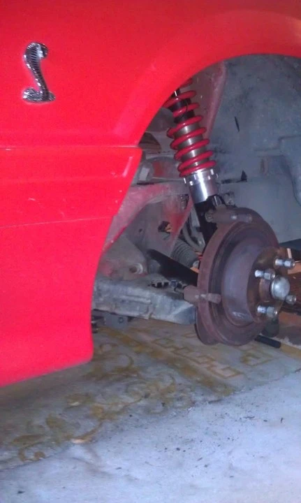

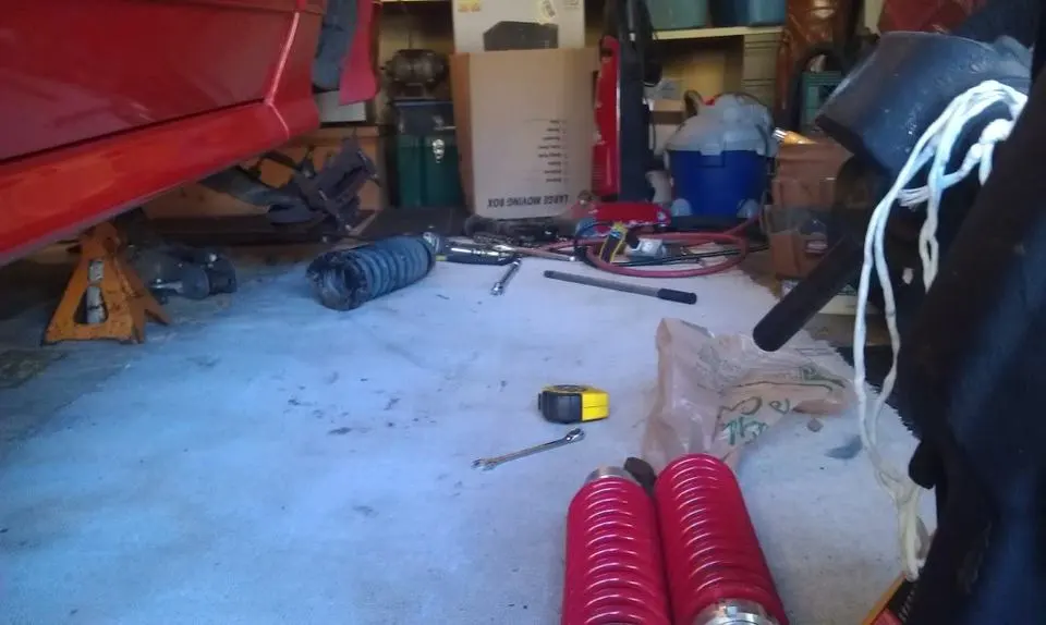

Well I got started this afternoon. I got the passenger side done. The coil is a 12 inch and when it is fully lowered it still doesn't tuck tire. not that that is a problem but my suspension guy at LPIracing.com said that 10 inch springs are the reg for fox bodies so I might go to one later. Tomorrow Ill have the full suspension done. I started later than planned today.
That last picture is with the suspension fully lowered on the coil.

the front looks fine to me it may settle a little bit depending on how many miles are on it. just keep in mind the front suspension still needs to cycle so I would cycle it and insure it doesnt rub.
That's a good point I will do that tonight. Have any of you had to cut hole in the hood support to get it to close with coilovers or do you cut the strut down? Im thinking about just cutting a hole into my hood support.
Yeah I think I will end up going to 10s if they don't sit the way I like. But for now they are fine and it is alot lower than it was. I just don't want to cut holes in my hood but its gotta happen.
