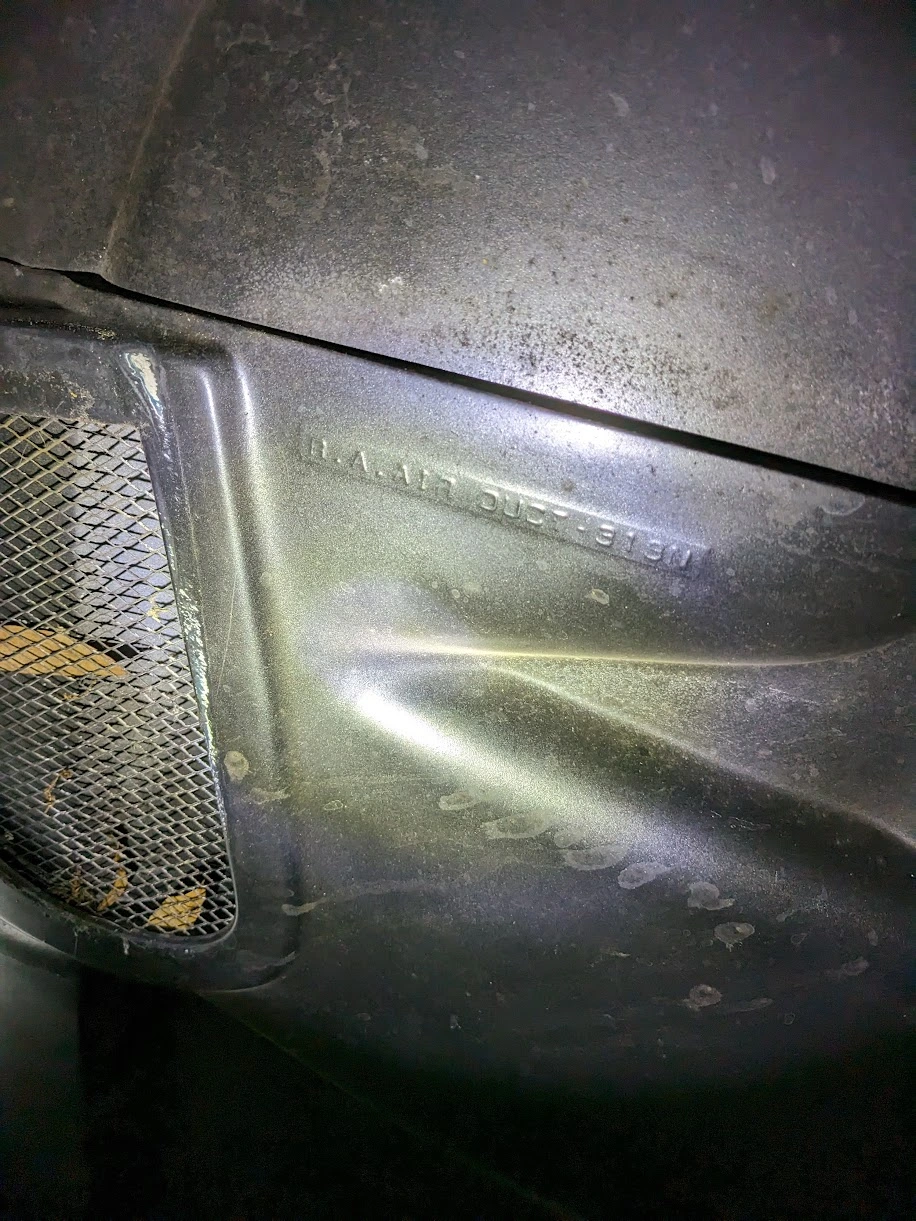

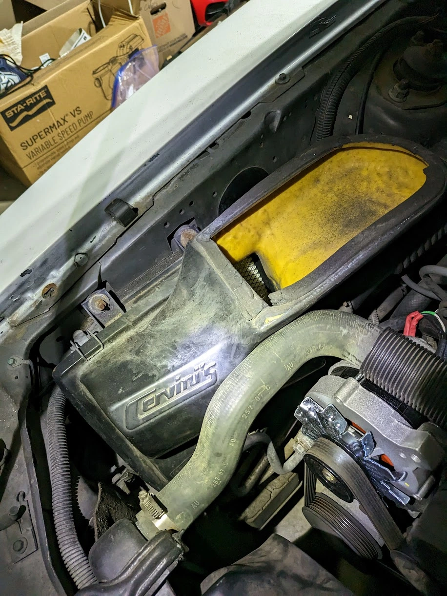

Yep, it's still installed and I don't plan to swap the hood, I really like the style. We got this hood surprisingly at a junkyard here in the Tampa, FL area many years ago (and for a stupid good deal as I recall). Unfortunately the air intake box (it's for this hood and a Cervini original part) is actually warped in a few spots now, so I have a new regular air intake box coming today from a junked Mustang to try to get a better seal/filtration.
If I can find the intake I'd love to get a new connection to the intakes on the hood, but so far I haven't had success in finding this (LMR has a few Cervini parts -- I think we have the Ram Air Hood 1.5" rise, but I don't know that this matches up).

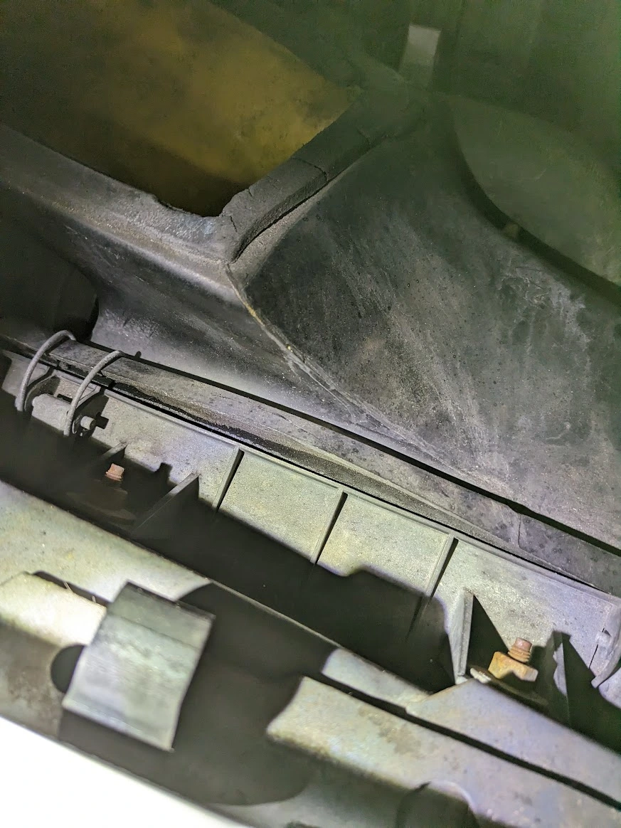

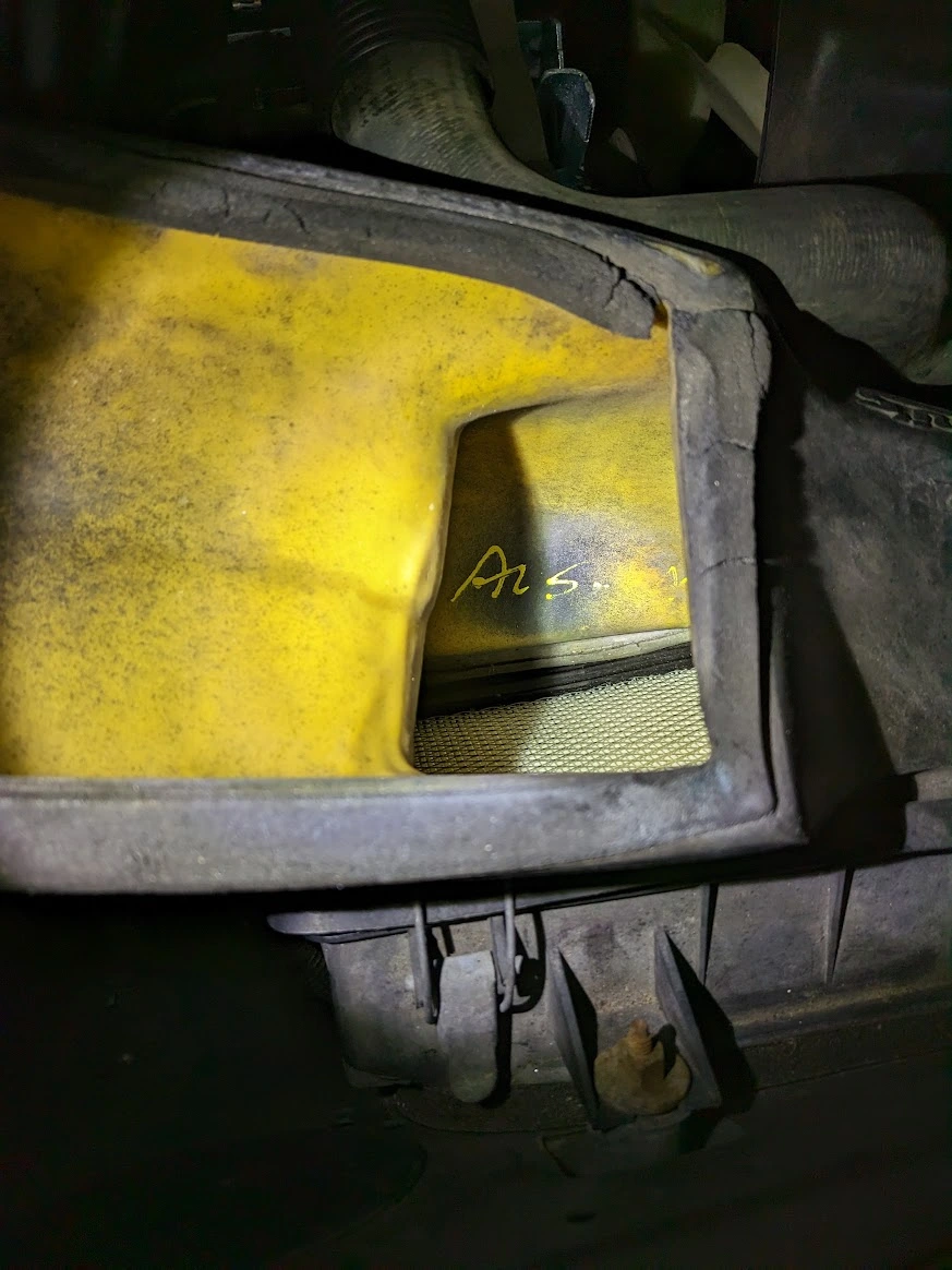

Here's a picture for reference of some of the gaps and the hood intake.

It appears that a new seal on the lower portion of the box where the hood piece meets is all that's needed, I don't see the warped part.
Sorry I took a bad photo in the second image of the bottom. It's the 3rd plastic clip (clip furthest from the front of the car -- closest to the firewall) that's warped at the bottom. So 2 of the 3 clips are fitting into the air intake housing, but the 3rd is not able to and it creates a bit of a gap/lack of a proper seal at the bottom.
One thing I didn't consider was taking my heat gun to it and getting it hot and trying to move it bend it back a wee bit. Maybe I'll give that a whirl.
You could also try to add some foam type seal material in the area of the gap, you still may not be able to clip it but the extra material in the gap could help seal it up. I would try that before the heat gun routine.
