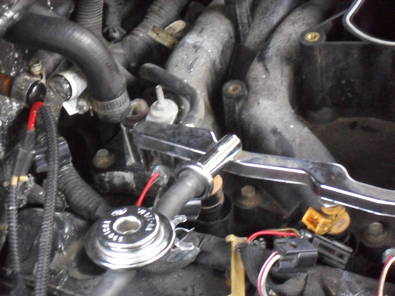

Last week, I was driving the car aggresively and missed a shift. After a few miles, the motor began to overheat and coolant smoke wafted in through the vents in the cabin. I had the car towed to the shop and they advised that the intake manifold was cracked. Upon looking at the old mainfold, I can see that the little port where the hose from the heater core goes in is completely cracked:
So I got a brand new replacement FRPP intake and some Ford gaskets and pulled the old intake and replaced it with the FRPP one. I torqued (18ft/lbs) everything down properly and followed the tightening sequence called for in the manual.
