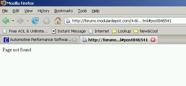

When I go here http://forums.************.com/4-6l-...tml#post846541 I get "Page not found". At a bare min I would guess you are down .15 to .2 on the CR. Remember on a 281 ci engine it only takes a cc or two.

sorry stan, where the ***** are, type modular depot, without the space between the words. For some reason stangnet won't let modular depot be one word, like this, here's what happens when i type modular depot as one word: ************
You have to type it in your browser manually. There are lots of pics on that thread.
It just does not work for. :shrug:

http://forums.modular depot.com/4-6l-2v-tech/102793-ptv-contact-need-help.html
copy and paste that to your browser, then remove the space between modular depot. stupid ass stanget won't let me post the URL proper.
