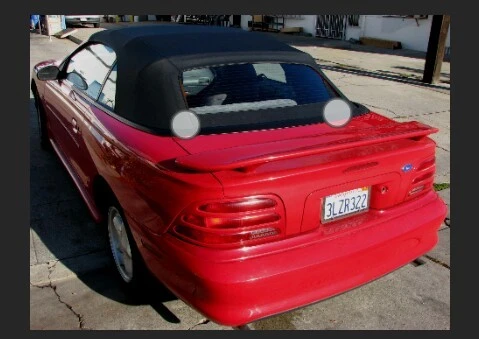

98 gt convertible leak.
I have finally managed to find it but don't know what to do now. There are 4 small hole tears located in between the 2 layers of material in the bottom left and bottom right corner of the rear window(the holes are on the first layer of material closest to the interior of the car). Any help is greatly appreciated!
I put 2 dots where the location of the holes are in this pic i googled.
This is a common problem. These are wear holes that come from the material rubbing on itself for many years as the top is raised and lowered.. I used a product called Storm Sure that I covered the holes with as best as I could. It has held 3 years now. The only true fix is a replacement top. I also make wear patches with this product. If you get a flashlight and see any place that is being rubbed thin, put some of Storm Sure on it as it dries clear. I am talking about on the inside of the top, not the outside. I also keep a towel in the well liner to catch any water that leaks in.
