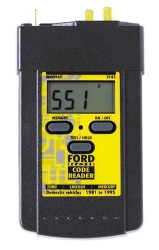

First thing to do is pull the codes. 1988 Mustangs don't have a working check engine light, so you'll want to use a code reader like this
View: http://www.amazon.com/INNOVA-3145-Ford-Digital-Reader/dp/B000EW0KHW
Run the codes before replacing another part.

Okay, a long delayed update....I bought a code reader, 0 codes in the car. It's not had an issue since changing the fuel filter and changing rear end lube, but I've only driven it on the highway for short distances. My wife is still nervous about driving this thing very far. It's put away for the winter at the moment, but thinking of putting a fuel pump in it just because...would I be wasting money, or do the in tank pumps act up and slowly die ? There's a few other issues with it as well, no heat or A/C for one thing (blower works fine). Cruise isn't working, 1/4 window motors need replaced...that sort of thing. But reliability is the most important thing...Being uncomfortable in a cool car is okay, being stuck on the side of the road sucks.

You checked the codes with the engine off, and then again with the engine running right?
Many people only do it with engine off thinking it's like an OBD2 cars. You need to get three code 11's. Two with the engine off, and one after you start it and run the codes.
Yes, I pulled both, with only code 11's
