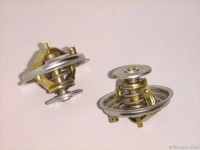

Well a couple days ago my thermostat (Motorcraft 180*) was sticking and simply wouldn't open. I drove the car around very hot (very stupid). I knew the t-stat didn't open because my heater was blowing cold air when my car was running HOT! Anyways, I put in a Napa 195* t-stat in as a quick fix and it runs about a bar and a half hotter than my old t-stat...normal? Would it effect it that much?
I also didn't disconnect the battery...would that do anything to the ECU's timing?
And just a fyi question...but how exactly does a t-stat work? Do they have certain spring pressures set to compress under a certain heat pressure? Temp? What makes it open in relation to a certain temperature...?
Oh and it doesn't seem like I did any damage to the engine...but I remember it pinging real bad when it was real hot. Detonation.

In the image, you can see that there's a small cylinder on the end of the t-stat that faces the motor. That cylinder is filled with wax. The car gets hot, the wax expands, and the plunger is unseated against the spring pressure. The temp that the stat opens at is varied (by manufacturer) by the type and/or amount of wax that's int he cylinder as well as the tension of the spring isntalled. The better t-stats are tuned to open and close more precisely than the some of the junkier ones that can be had at many auto parts stores.
Not disconeecting your battery should have had no effect whatsover. The AIT sensor and collant temp sensors are always varying in their readings and sending information back to the EEC. The EEC has no clue whatsoever that you changed the stat (nor does it care). All in knows is what the current readings are from your sensors.
You're the only person that can judge whether your motor was damaged or not (since none of us are there in front of your car) but it doesn't sound to me like you've done it any harm. You've got written out any symptoms of additional problems after changing the stat.

David, to burp it, park it so the driver side front is higher than the rest of the car (or jack up the driver front) and (ON A COLD MOTOR) remove the cap and let it idle. The cap orifice being the high point in the system should allow air to make its way up there and purge. If your new stat had a bleed hole on it, this will help purge air from the bowels (loosening the ECT can help otherwise).
FWIW, the performance stats have a shroud around the wax pellet to protect it. Otherwise water banging against it can damage it, and air pockets can cause it to get out of calibration (the air pockets really can work it over).
