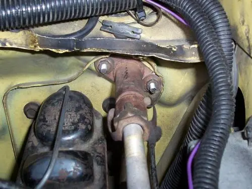

You will also need this adjuster tube:
This is not reproduced, sadly. But perhaps you can fabricate something, if you get the original cable.

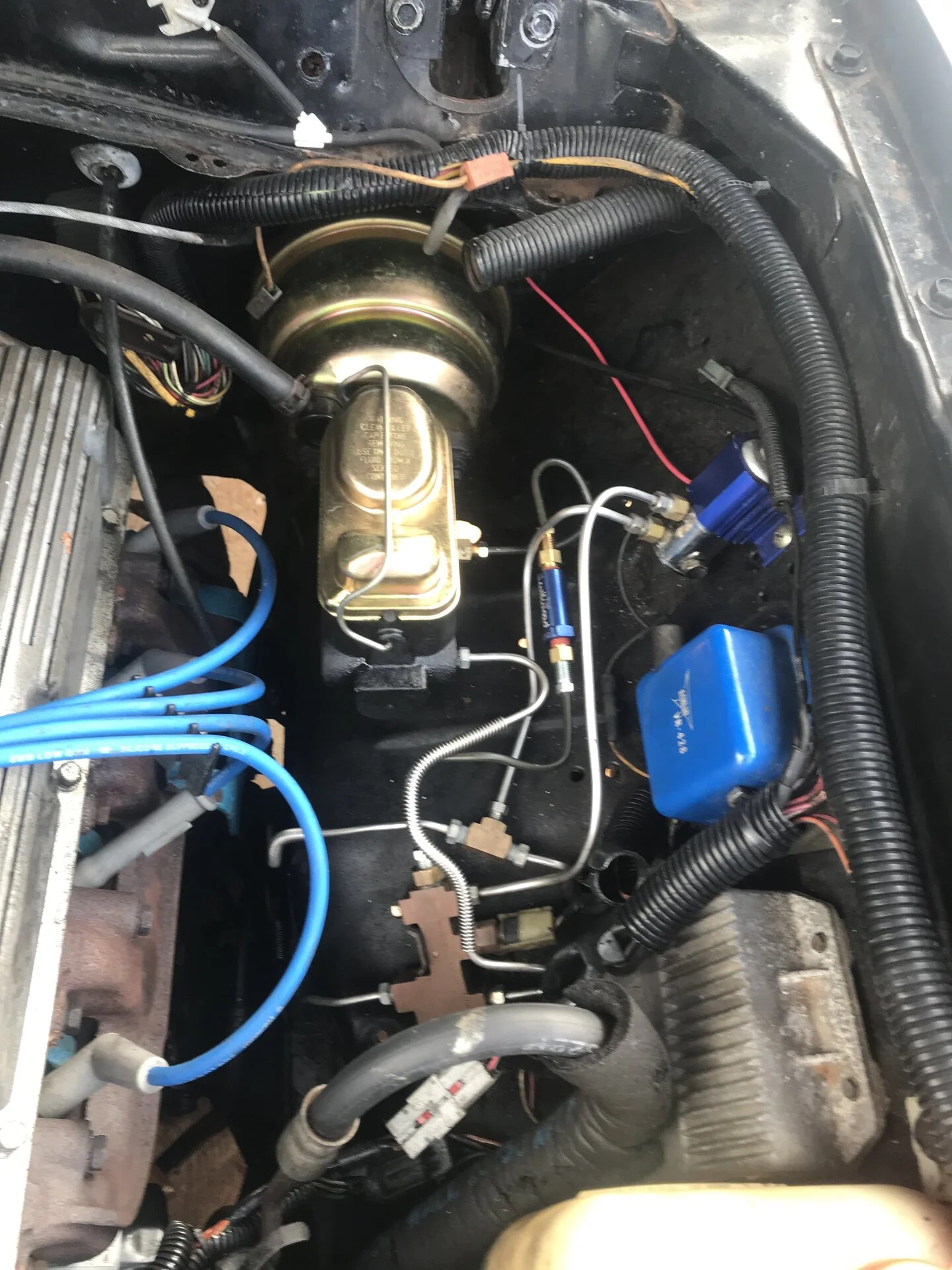

I look at the adjuster tube and think it won't get along with brake booster?
I need to go out and stare at car some more.

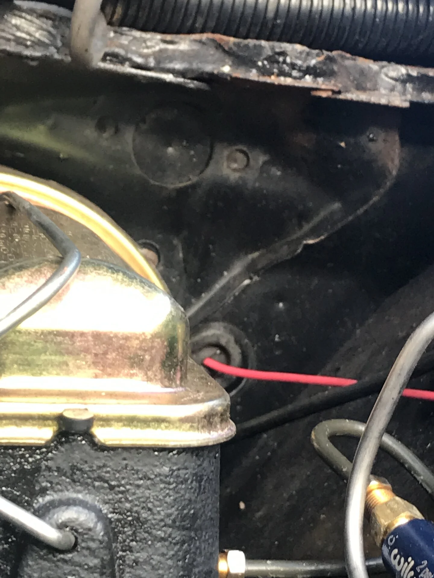

I converted an auto to manual years ago. I used the stock setup and was able to find an adjustment sleeve at a scrap yard. Chance of that now is real slim, but what I found was that the auto car already had the reinforcing bracket spot welded in place. You'll need to drill 3 holes once you locate the sleeve, 2 clearance holes for the mounting bolts/studs, and a larger hole for the cable. If memory serves, that hole is 1 inch, but you'll use the existing bracket as your guide. All you'll really need is a properly sized hole saw that fits that existing hole and you're good.

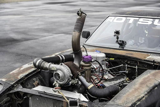

The best bang for the buck setup without exhaust clearance issues on the MII with a 289/302 is the rotsun setup from roadkill:

I bought my clutch cable recently from Amazon. It's Pioneer brand CA 305. It fits better then the stock one. Factory cable was tight against the master cylinder but the new one runs further into engine bay and has more room near the header.
I had to cut 2/3 of the spring off otherwise it fits perfect.
Factory Cable from original 4 speed car.
New Cable. Mounts fit perfectly into existing hole.
