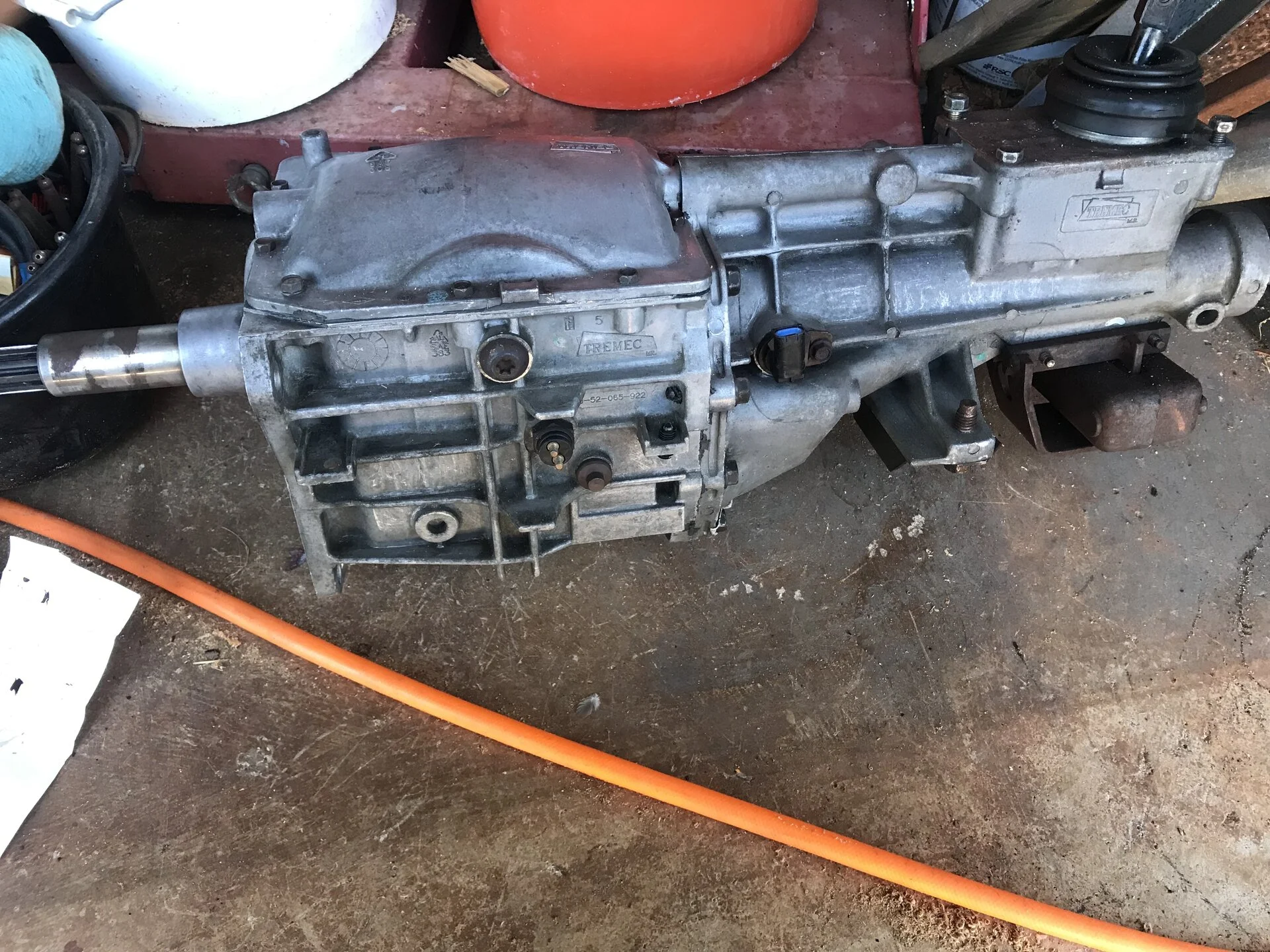

Help I want to put this T5 in our Cobra II

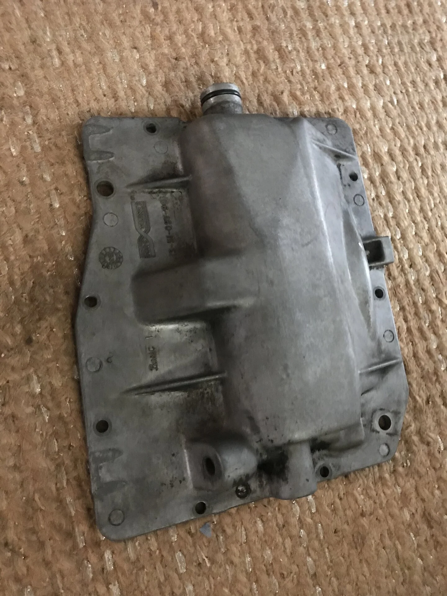

I did find a 1992 style top so I could hook up the neutral safety switch
13$ was the right price, but the switch itself is 20$
Some one just told me this switch just sends a voltage signal to the computer so it won't hook up as I'm imagining. Is that correct?
It may be my faulty memory but looking at your cable the spring appears shorter than mine was. Have someone in the car pressing the clutch pedal as you watch the spring. If it's binding then cut. I want to say the pioneer cable spring was almost 10" long out of the box. I left about 6" on it.
Reactions: 2Blue2
Nothing on passenger side but fill and drain plugs
Nothing on the top cover.
Just what I see is the reverse light sensor and the speedo sender plug, I guess.
I am pretty sure our II's used a switch on the clutch pedal for neutrel safety and cruise control. I remember seeing the bracket to hold the sensor on the pedal. My rad4 only has the one reverse sensor. The wiring diagram only shows 2 wires to trans which are reverse.
Reactions: 2Blue2
From what I've read. It was a neutral safety switch for cruise control. Not an option for the II's as far as I know. You don't need it.
Go to MDL's website and click on the FAQ's for T5's. I think that is where I read about it.
