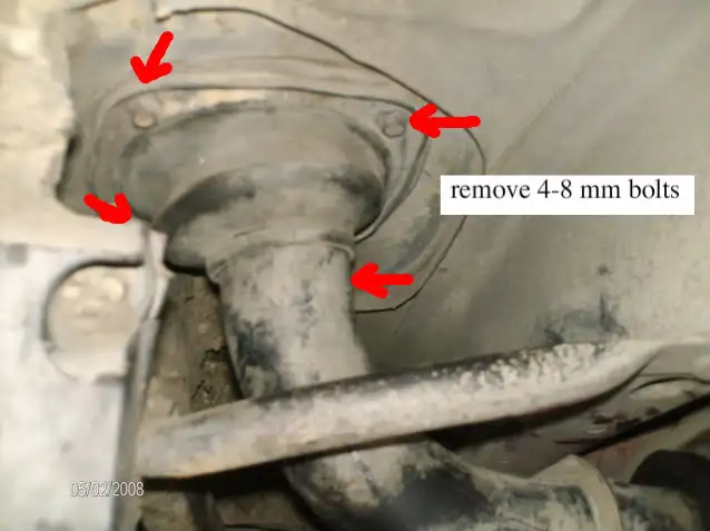

need help identifing a part. i kidnapped this pic from the 94-95 tech page
it is the gasket where the red arrows are. mine is completely gone. anyone know where i can get one?

It's part of the gas tank filler neck. I may be wrong but I don't think it's serviceable separately. IE it's part of the filler neck itself. If so, a replacement filler neck should fix you right up.
Note that I said "replacement" and not "new". I believe that Ford has deemed the filler neck for 98 and older MY's as obsolete. So the after market or salvage yards are your best bet.
One source for salvage yard parts is car-part.com.

Viola!
http://www.latemodelrestoration.com...ustang-Filler-Pipe-To-Trunk-Floor-Rubber-Seal

I got my filler neck from tousley ford... call them up an talk to steve

I cut up and used a master cylinder rubber from the HELP! section of Pep Boys to replace mine. No leaks and cost next to nothing.
