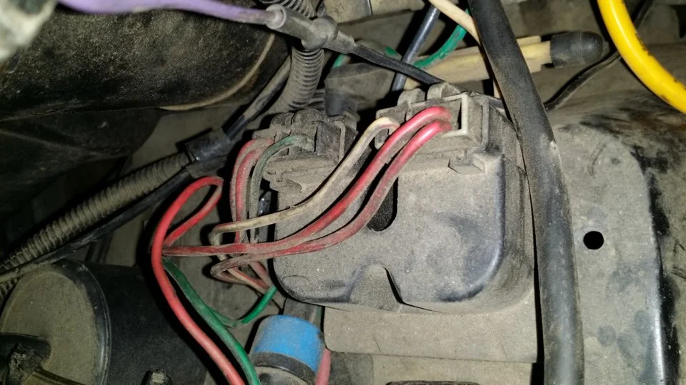

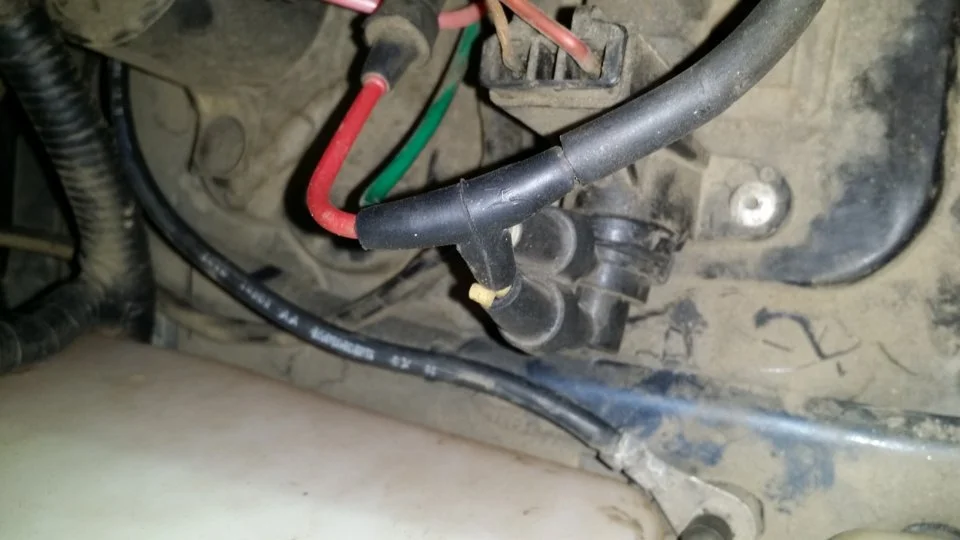

Hi I have an 86 mustang engine and am having trouble finding out which vaccume device is the evr for the egr valve. I have two pictures. Ones the evr and I'm not sure what the second is. Smog?

It's behind the strut tower it has a vented cap on top of it and it has a vacuum line that goes to the egr valve. The TAD/TAB solenoids are together side by side under the egr vacuum control solenoid. So the egr will be the one at the top.

Your evr looks nothing like the 87-93 model.The one in your picture that has a green and red vacuum line coming off of it looks like the evr solenoid.It has one wiring harness attached vs the other one in your picture which has two wiring harnesses attached to it.One vacuum line goes to the egr valve and the remaining line goes to supply vacuum(vacuum canister or intake fitting)

One vacuum hose runs from evr to the rear underneath side of the upper intake,connects to the small vacuum fitting beside the fuel pressure regulater vacuum fitting.The other hose runs from the evr to the egr valve.
