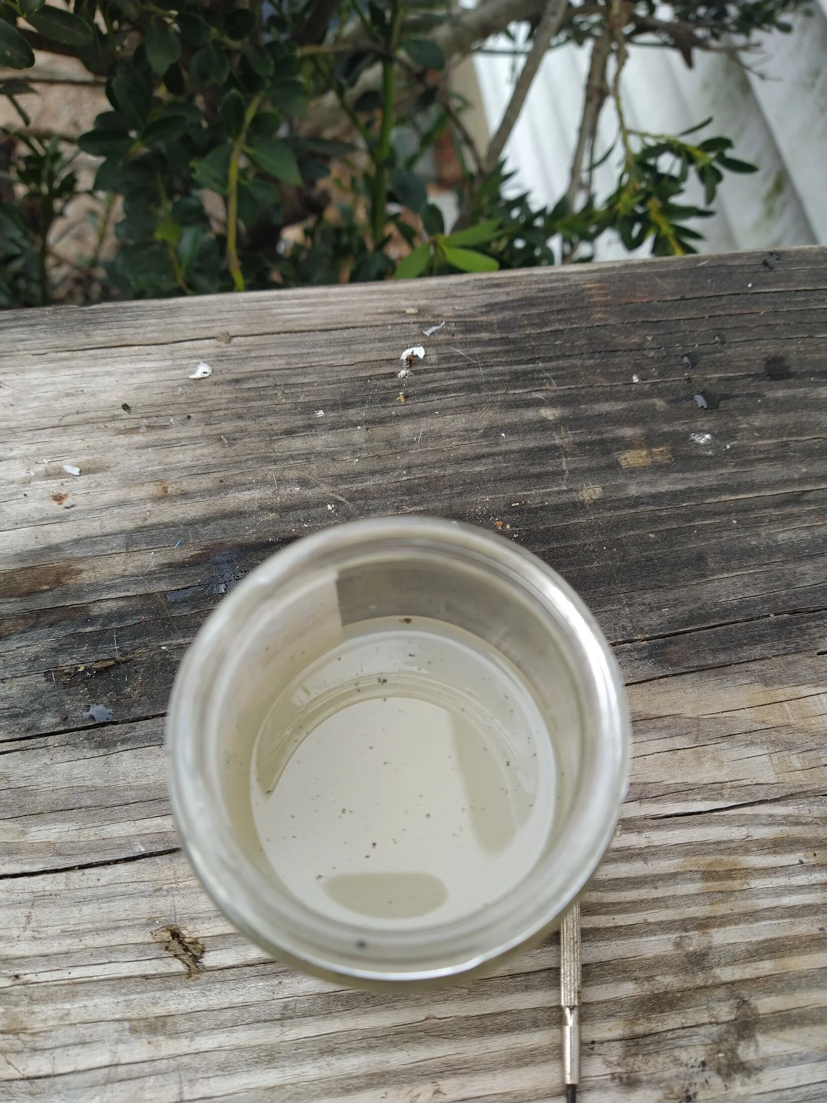

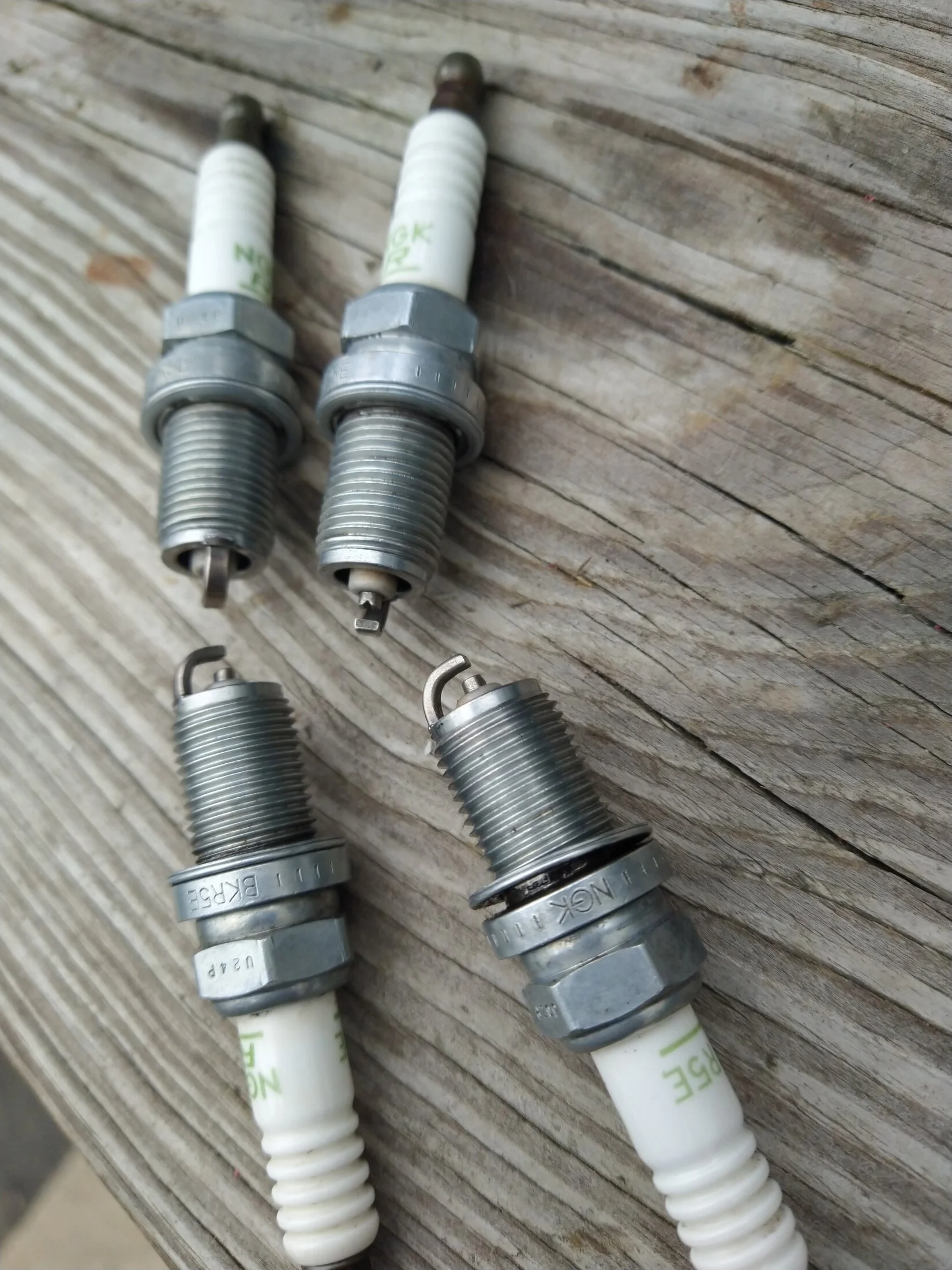

I remove and clean mine in a shotglass full of lemon juice to decarbonize them then rinse them in a vinegar bath for a few mins then finish them off with rubbing alcohol..
This method works really good for sparkplugs too and saves money on harsh chemicals.......

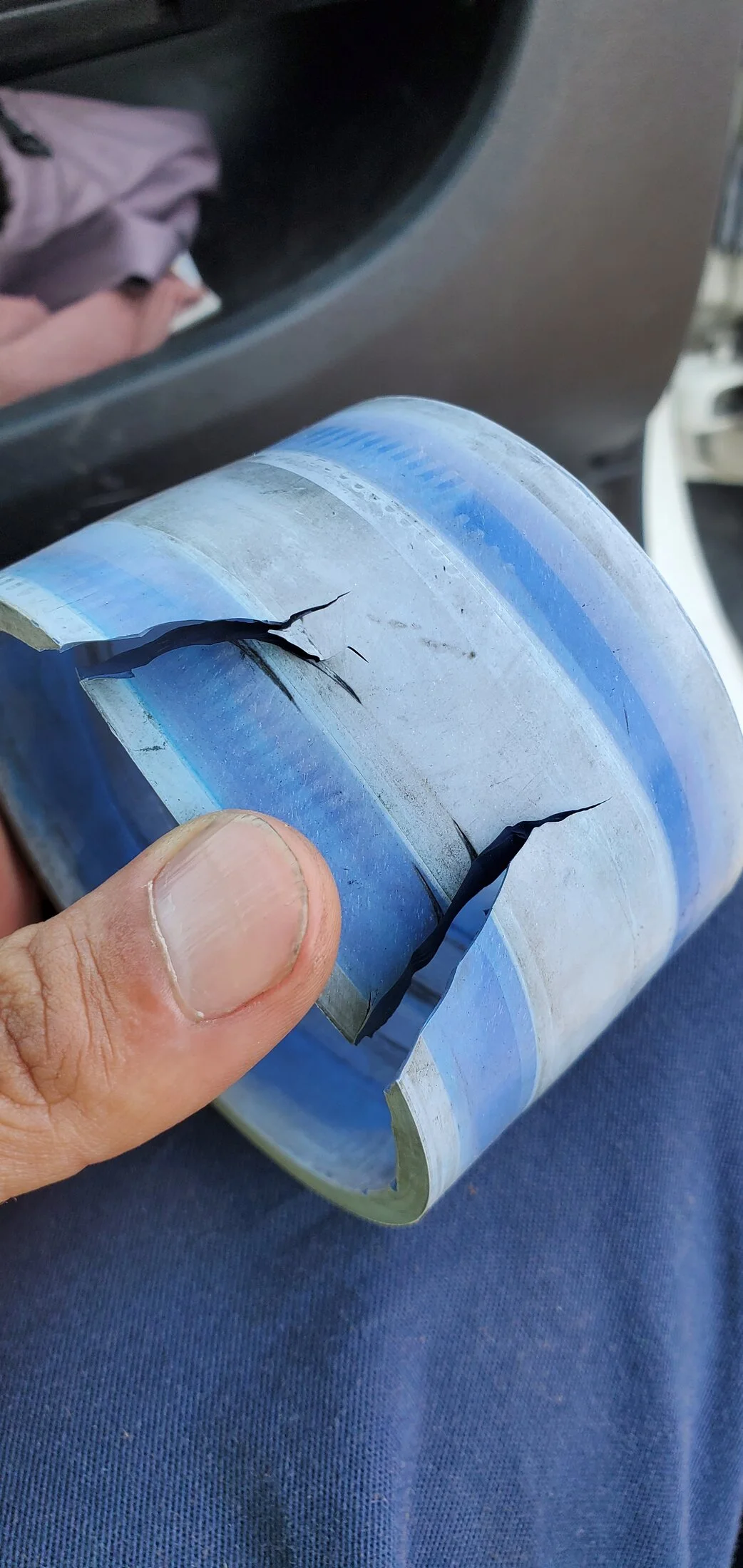

So I don't have any drivability issues but I did find that the coupler that connects my intake tube to the throttle body was torn and cracked on the bottom side
I’m surprised that didn’t throw a p0171 and p0174 by letting unmetered air in!
Good find tho
Disconnect your battery for 30 minutes after fixing that coupler. Let car idle for 5 minutes, then turn a/c on and idle for another 5.
This helps the PCM relearn the idle and establish fuel trims
