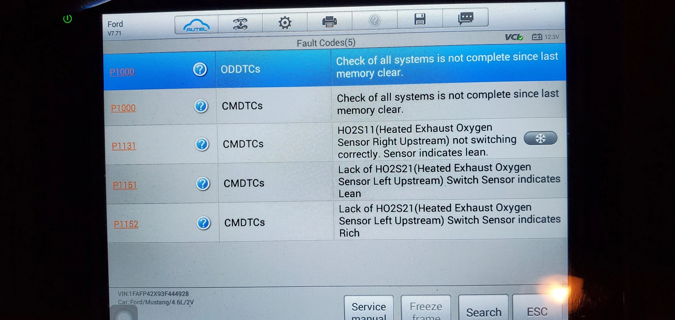

So for the hell of it I disconnected the battery for 30 minutes and then let it idle. It surged for a few minutes on first startup then evened out. I did end up putting the factory throttle body back on and started the car back up. Now I have different codes that popped up. P1131, P1151 and P1152

So after installing the factory throttle body I had a lean and rich code show up for the drivers side O2 sensor
