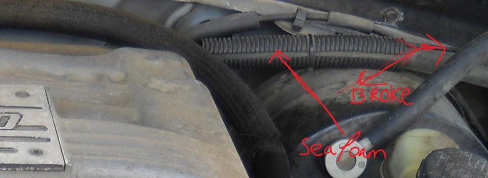

I think I have massive vacum leak, car is really high idle and loud on the right side of engine, all i did was take off the brakeboost hose, the one connect to the intake, and their a little hose above it, i broke it, i dont know if that the cast or not. 95 mustang gt automatic.
I broke off this small hose on the red arrow picture, what is that hose for ? and i use the big hose on red arrow to put in seafoam
You probably did some damage to the brake booster grommet. They get old and hard and leak if you mess with the brake vacuum hose.
is the gromet u say is the one the circle thing with the hose connect to it ( like in the picture ? ) if that the one u talking about, i dint touch it.
Pull it out of the brake booster housing and inspect it for hardening and cracks. New gromments are available at the auto parts store.

check everything, and found no vacum hose that i think might be leak. turn on the car, it still high idle and loud noise like a leef blower on intake air filter ( MAF sensor ) area, i unplug the MAF and car is die, then i crank again and car is idle beutiful. and no noise on air intake area.
went to part store and bought some MAF cleaner, and the torx tool thing, take off the MAF and the side MAF ( facing the air filter, im not a big fan of after market air filter that on fender at all. ) is so dark and burn, clean it off, put back in and car still high idle, but if i unhook the MAF car idle fine, and no noise like leef blower, i rev it up and rmp slowly back down again.
what happent ? i did clean the IAC and check for vacuum leak.
if I plug my MAF , car idle fine, little rough but no high hang idle.
Did you follow the vaccum diagram I posted to make sure all the vacuum lines were properly connected and not broken or cracked?
Have you dumped the codes? You'll get at least one code 66 for disconnecting the MAF.
I had a high idle issue a year or two back. It would not always do it and I never messed with unplugging the MAF, so I don't know how that would have affected it. I cleaned the IAC a couple of times, and it looked really clean inside. I ended up replacing it out of frustration, after replacing the TPS with no success. After installing the new IAC, the problem went away. Cleaining it seems to work most the time, but in my case it did not. Can't say thats your problem, but perhaps you can give it a try, or borrow a friend's.
